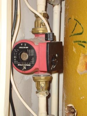

I've attached a picture of the circulator. Could someone tell me what are the fittings above and below the circulator? Are they stop valves? I am pushing my luck thinking I may not need to drain the whole system, which is something I don't know how to do...maybe this is out of a DIYer's reach?
the fittings are isolation valves
Yes. When the slot is across the pipe, the valve is closed. But, as they do not get used very often, they may be stuck; so be very careful. They may also leak around the on/off screw.

Ouch, the spindle was really difficult to turn. It seems to require a special tool. But I did turn it a bit, only about half turn. Then I turned on the power, it didn't work.......

only tool you need is a narrow screwdriver
sounds like its seized
when the valve is on man its mid position so yes hw & ch
Kevplumb, thank you so much for all the useful information. You are great. It is all working now. You were correct that pump rotor could stuck. You were also right that turning the spindle a bit could solve the problem. It did. The boiler is working for 10 minutes now, and is still working. I am sure the problem is gone. Thanks soooo much. I really appreciate.
by the way, the first time i turn the spindle, it didn't work. But I did all those again and also change the speed. It worked.
