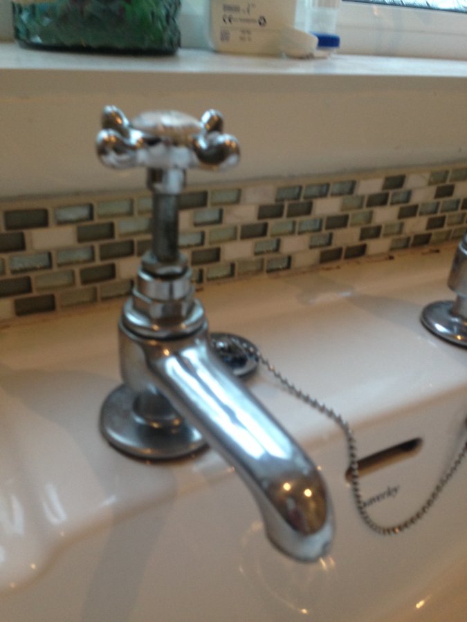

Hi
We have a real problem with our upstairs bathroom sink tap. Every time we turn it on and it starts to get hot water through it, it starts clunking really fiercely and the water comes out in spurts. If you turn the tap slightly either way it stops at clunking. We are running off a Worcester Combi boiler with pressure at approximately one bar and every other tap in the house seems to be okay. Can anyone give me any guidance as to what this could be? Thanks in advance
If you are confident to dismantle the tap and fit a new rubber washer, that'll probably sort it.....the washer is sticking down a bit as its spread with age, water pressure blows it off its seat and starts it vibrating. (A new jumper - that's the bit the washer fixes to - may also help but I doubt if they are available so try the washer first.)

Can you post a pic of the tap?
John :)

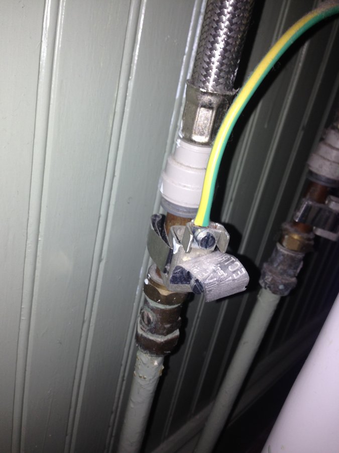

It is a typical tap - photo of tap and pipes under sink attached - no obvious valve though???
You see that earth cable connection onto the copper? The isolator is just below....you turn that slotted screw 90 degrees to shut the water off.
There's no guarantee that there wont be a drip afterwards though.....it looks a bit crumbly! You won't get a flood anyway.
The tap is a breeze.....you have to stop it turning at the basin, but the insert will just unscrew revealing the washer on the end.
