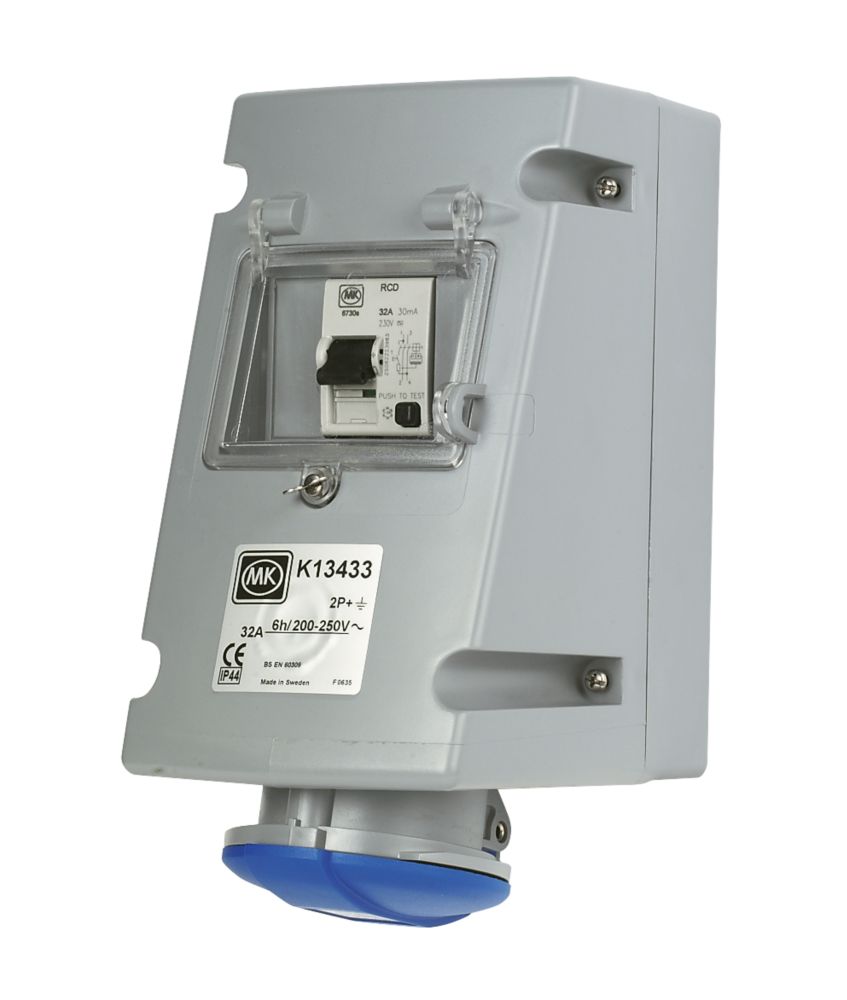

To ensure the rating of the socket is not exceeded you can either put a current operated disconnection device at the socket or at the supply.
At the supply would mean a cable for every socket and at the socket a single cable could supply many sockets.
This
ae235
is a 32A version but shows the idea of fitting a RCBO in the socket outlet so many sockets can be daisy chained from same supply.
As to using a ring circuit the calculations to ensure there is not an overload could become complex one can't use the 13A example and just use 16A it will need to be calculated. Can't see the point may as well just use 4mm or 6mm cable in first place.
