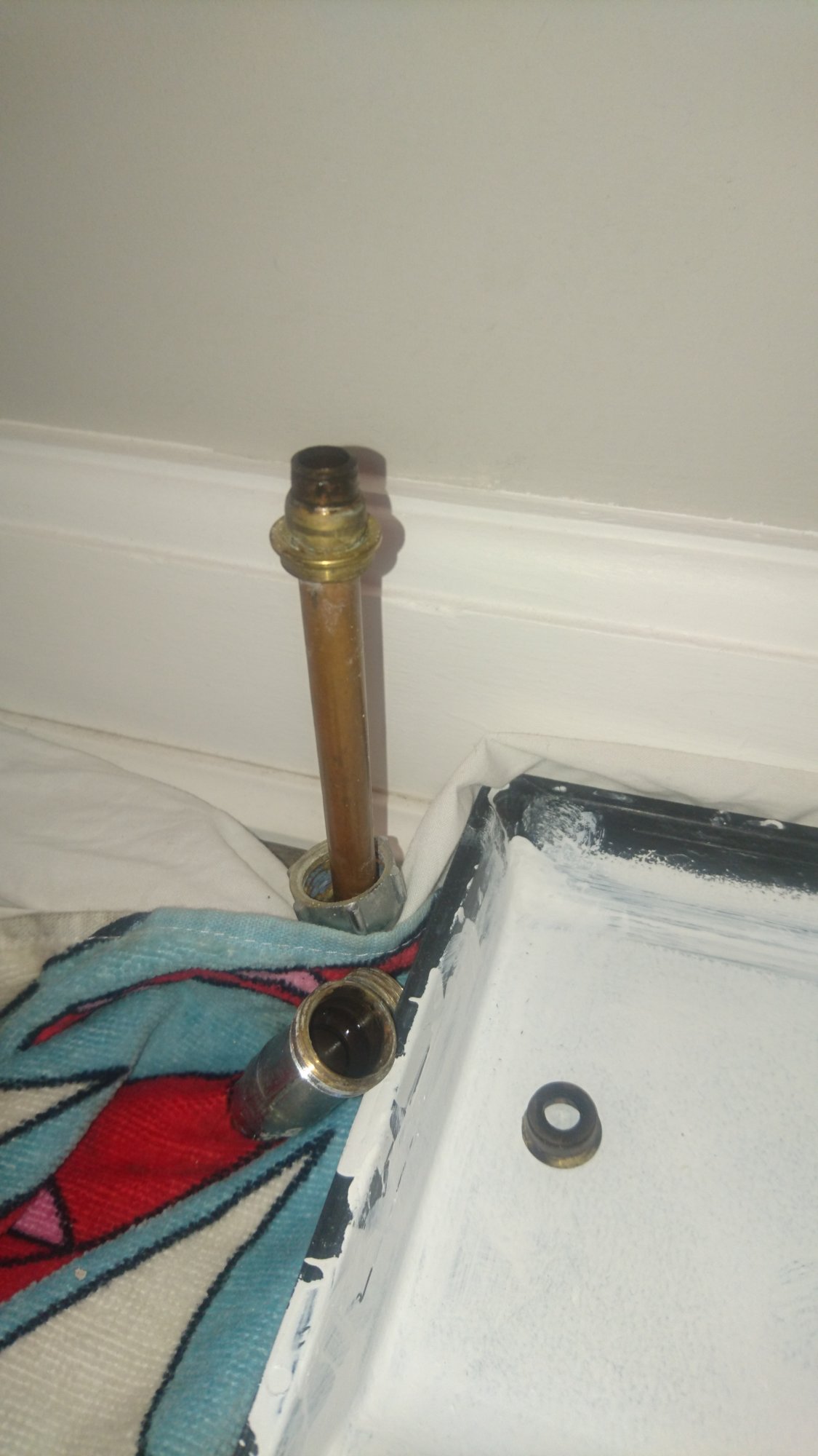

Just removing my old rad valves to replace with new ones.
The existing valves use reducers to accommodate a 10 mm pipe to 15 mm valve body.
The old adapter seems to come in two separate parts with a 10mm olive sandwiched in between
The new ones seem to be a single part without an olive.
http://www.screwfix.com/p/reducing-set-15-10mm/70435
Can anyone tell me if this the screwfix item is the correct part i need to fit the new valves and would /how would i fit an olive in there if required?
that's the reducer you need ,no olive needed.it does not require one as it compresses directly to pipe/ valve body.

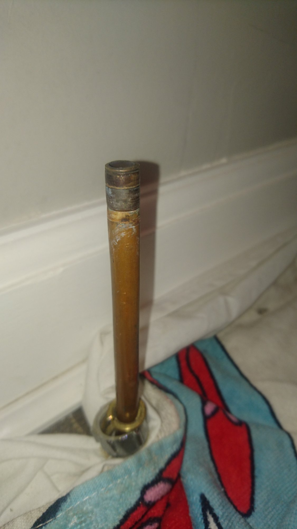

In terms of future work and the potential need to remove the valves for whatever reason, which type do you reckon is less hassle to remove and replace
( for a diy'er)?
I know they'll both have to be cut off but I've been reading that the one piece versions can distort the pipe a fair bit which will also need cutting back in order to get a good seal when refitting new.

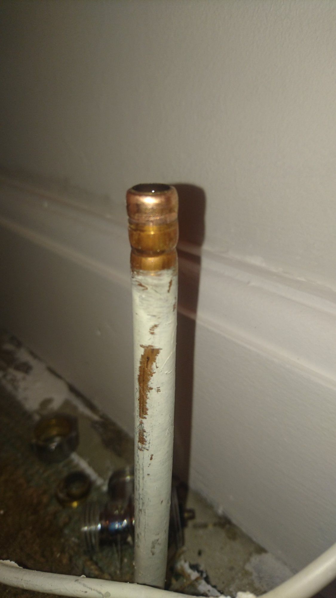

With the exception of the olive, the top and bottom section of the existing 3 part ones will come off by hand and the pipe looks okay.....
Im yet to cut off the olive and inspect what sort of shape the pipe is in underneath however.
if you overtighten either type the pipe gets crushed ,once that happens there is no alternative but to cut off the damaged section ,or replace a section of pipe. a common mistake for diy'ers is using too much force ,thinking the tighter I can make it ,the less likely it is to leak. Quite wrong !

The existing pipes are burried in concrete with no movement which means ive got no margin for error if i balls this up.
Wish me luck boys
you can solder a new section of pipe in ,low down near floor level , so it's not really visible , if you have to .are you using a wheel cutter to cut pipe ? miles easier than a hacksaw .
