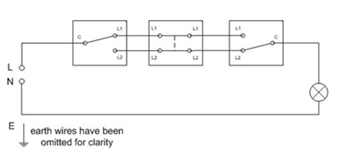

Are you sure it would work?
I've just drawn it out, and it seemed to be I couldn't connect both switched lives for the lights to the same terminal so it works.
Could be wrong of course.

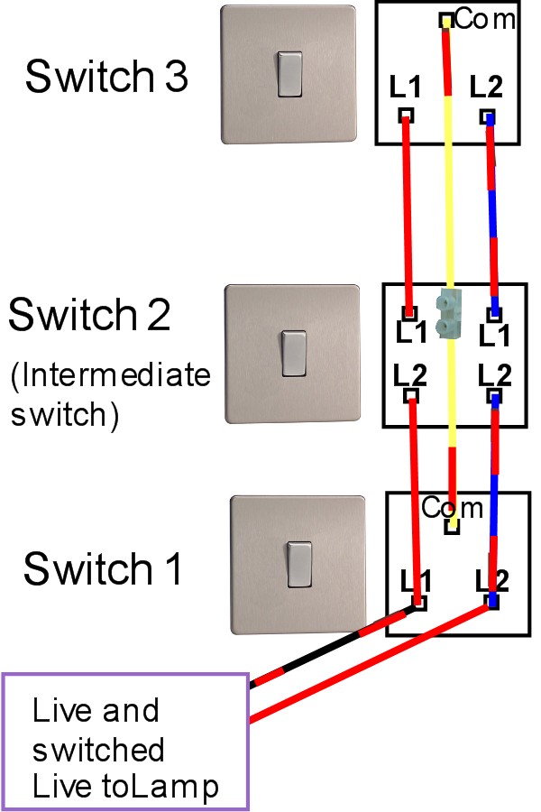

I have thought some more and it could be done with the existing wiring if the commons wire linked at the intermediate, the switch wire put into common at one end and the live made safe.
Then at the other end the wire that is in the common connected to the switch wire with a connector and the live put into the common it would work.
View attachment 130733 I have thought some more and it could be done with the existing wiring if the commons wire linked at the intermediate, the switch wire put into common at one end and the live made safe.

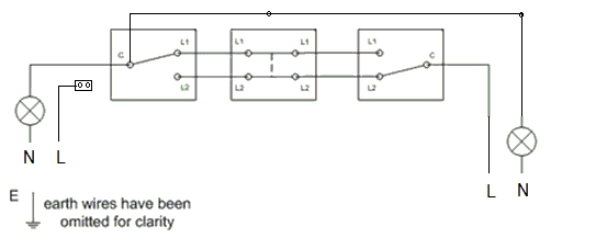

Yes, I see what you're trying to do.
Though your diagram only shows one light.
The 'third' core in the 3 cores can be used used to supply the second light, with connectors.
I'd draw a revised diagram, detailing how the 'third' core in the 3 core and earth cable would supply the second light, I'm sure someone will do it soon...
That's what I was trying to describe, the image I posted was just another way of wiring an intermediate circuit. I don't have any drawing programs.
