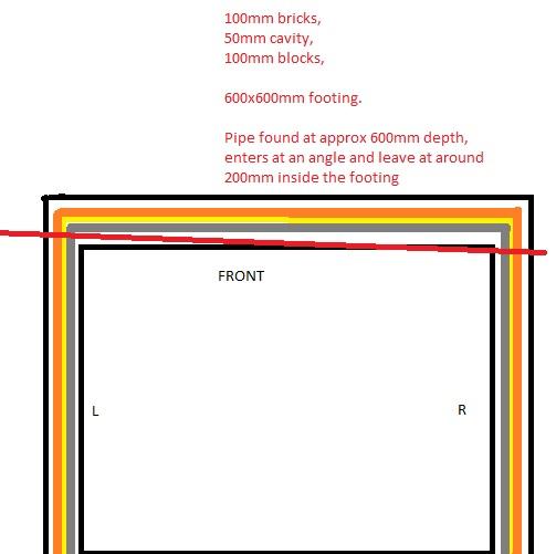

Hoping somebody can shed some light on this issue for me. I have purchased and collected a 2nd hand conservatory on ebay. We began digging the foundations today at a size of 600x600mm. Unfortunately we found a shared sewage pipe runs straight through the foundation. Details and a diagram are below (not to scale but gives a good idea).
I cannot move the pipe, so is there a way of building around this sewage pipe?
The conservatory is 3m depth x 3.25m wide.
Footings 600x600mm.
Pipe enters right hand footing level with the 3.25m footing (see diagram).
It then continues at an angle into the width footing, by the time it reaches the other side it is approx 200mm inside the footing at a depth of approx 650mm.
Any help on this will be greatly appreciated.

Looking at your drawing suggests that the pipe only clashes with the brickwork at two points.
Or am I reading it wrong?
Noseall - its a rough drawing, the block work begins 175mm in from the edge of the 600x600mm foundations. The pipe is 600mm below brick work in the foundations. A birds eye view will show the pipe runs beneath both projecting walls and the width wall.
Jak
In your sketch the black line shows your foundation slab which goes lower then the sewer. Then you block up to the pipe and put a pair of lintels in where the pipe pierces your underground wall skins. leave at least 1" of clearance all around the pipe which you fill with pugging or now a days polystyrene.

At the moment the pipe is below my 600mm foundation - do you recommend digging out beneath it? And the side which is still under earth?
The pipe wont be piercing brick work as this is to be a trench fill, so will only pass through the concrete foundation.
To clarify i need to protect the pipe across its length within the concrete foundation.
Jak
You need to protect the pipe from the building and not fully envelop it.
As I said earlier, finish your footing below the pipe.
You may need to dig the foundation wider at the point where the pipe encroaches onto the masonry. This is so that you can provide brick-work beyond the building line then lintel back.

A technique I once used was to put in a padstone out side the building. So the padstone was bridged to the side foundation with a lintel. From this lintel there was a second lintel that ran across a sewer and sat on foundation strip for the back wall. Its a long time ago, but at the time the lintels are not that big, say 300 X 150 X 1.4m with three bits of 8mm steel in each. Building the shuttering was fiddly, and you have to let the bottom one cure before you can build the one sitting on it. You could terminate your side foundations to what your water board consider a "safe distance. then put a pad stone in line and the magic "safe" distance away on the outside of the building. Then have a couple of pairs of pad stones (the safe distance etc) along the back wall. Then finally cast the BIG lintel across all four of them that will carry your rear wall. Watch out for your levels each lintel will consume some!
