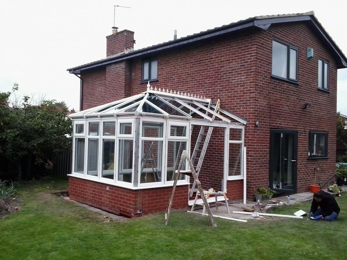

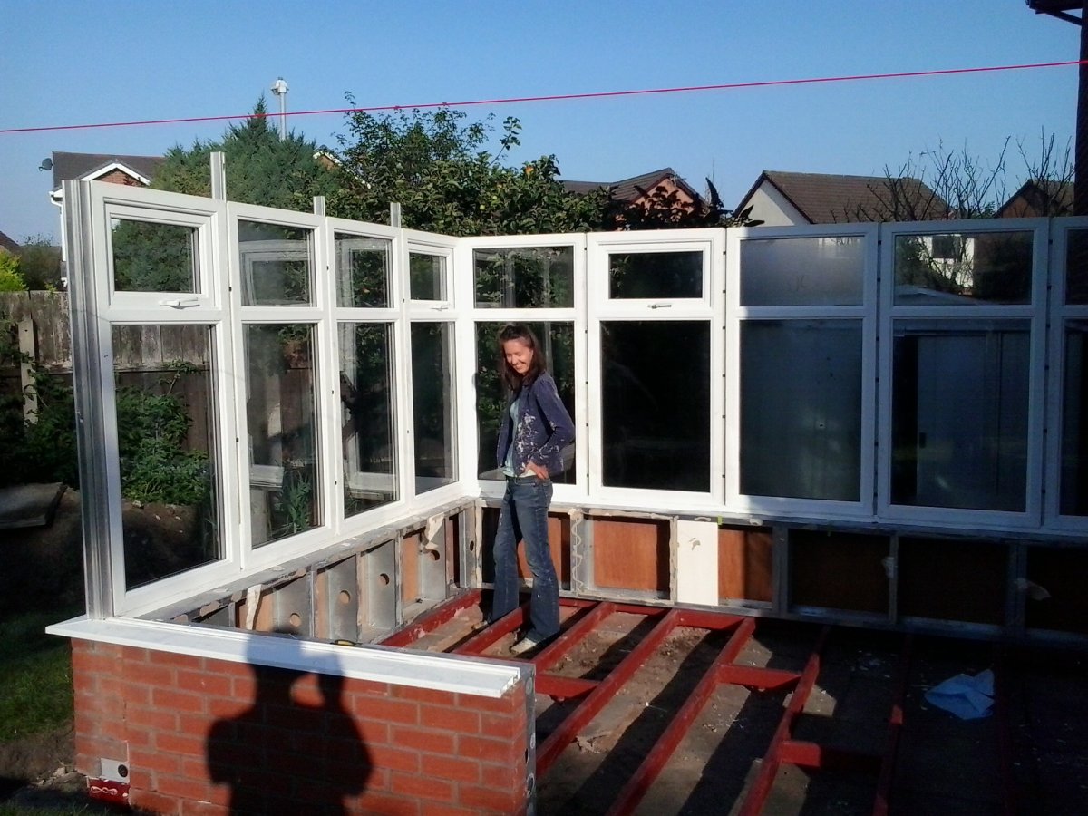

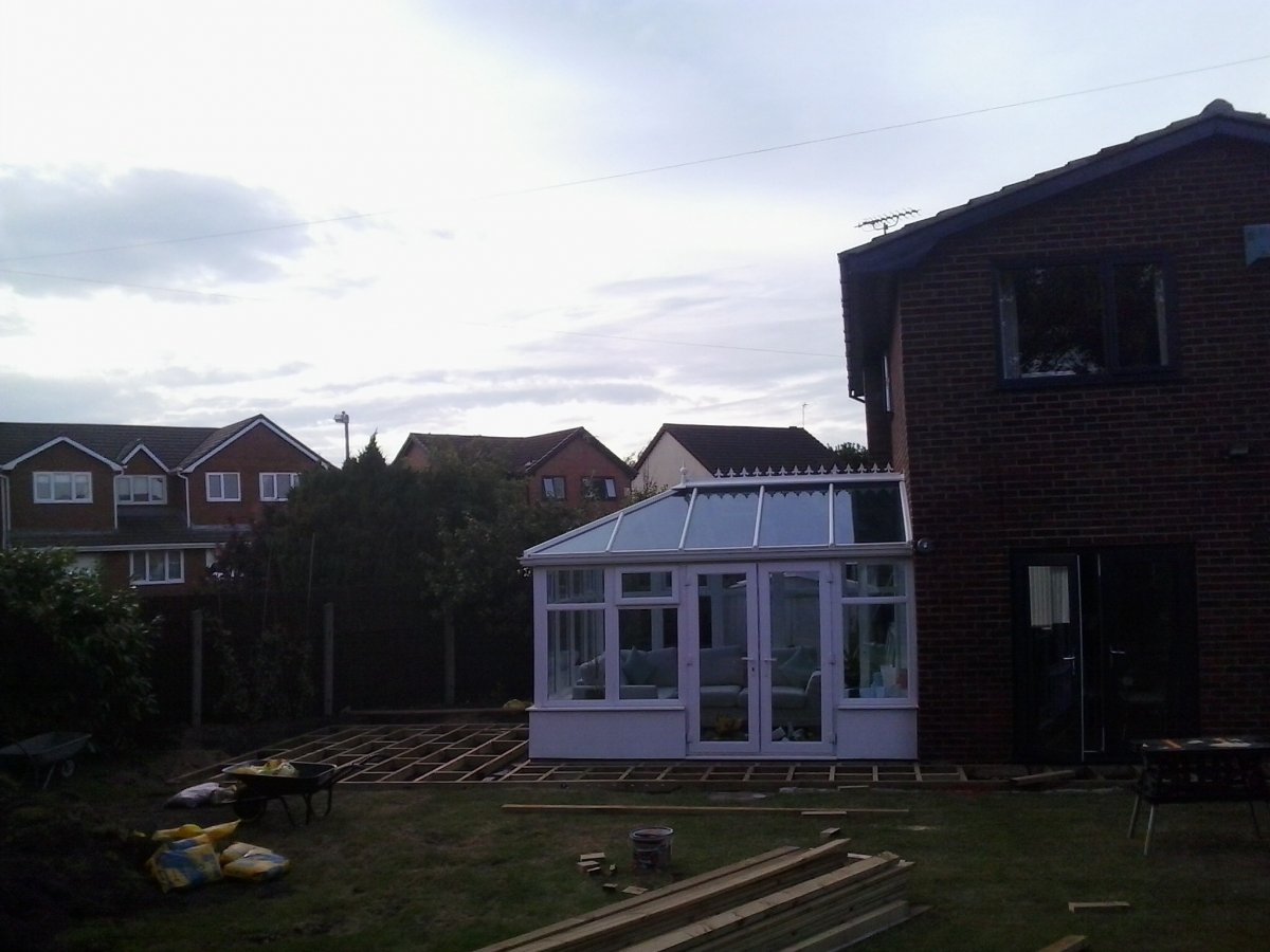

I agree the video is a bit strange as it needs to be above ground level. I had to dig down the ground level around my one and then built a deck
Here's a few pictures :
All in cost me £2.5k including the new opening and French doors into the house. (The conny was second hand on eBay).
