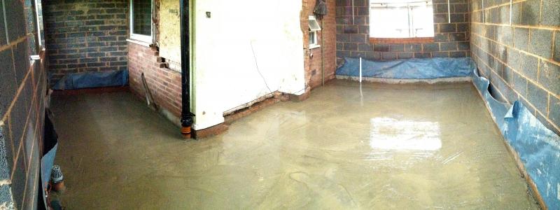

So concrete for the floor slab was pumped in today, and now I'm finalising my plans for the insulation & screed.
I'm having very little success in finding anyone who wants to even quote for a sand & cement screed, let alone LAY it, so I'm going to put down EPS 100 @ 120mm and have an anhydrite screed at 40mm. I can have it done early next week, which gives me just enough time to get the insulation down. As it should be hard enough to walk on within 48 hours, that also means that I can get the electrical first fix done too, and then get on with insulating the ceiling and then there's just plasterboard & skim to go. I might yet be 'in for Christmas'.
