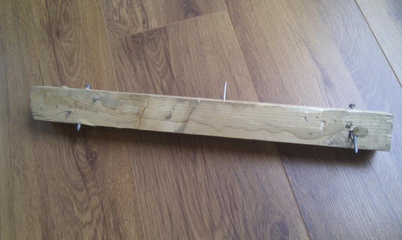

Since then, I have opened a small inspection window in one of the creaking stairs. Inside, I found this piece of wood:

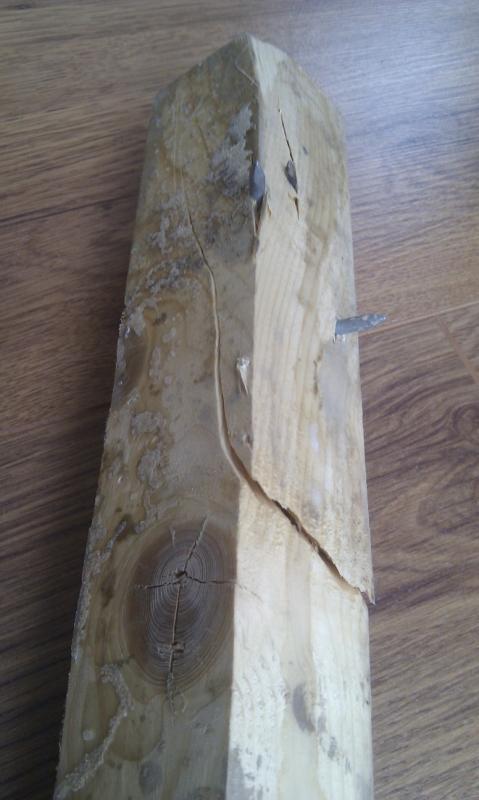

I suspect that this was being used as a glue block to secure the tread to the riser. However, in all the photos I have seen about glue blocks and wedges, I have never seen anything like this! Moreover, it appears that they have used massive nails to secure it to the stair, causing the wood to split:
What I would like to ask is: is this a standard glue block? Could this be considered sub-standard work by the builder? In my opinion, using this block of wood as a glue block and nailing it as shown is a recipe for disaster and should be considered sub-standard work. What do you think?

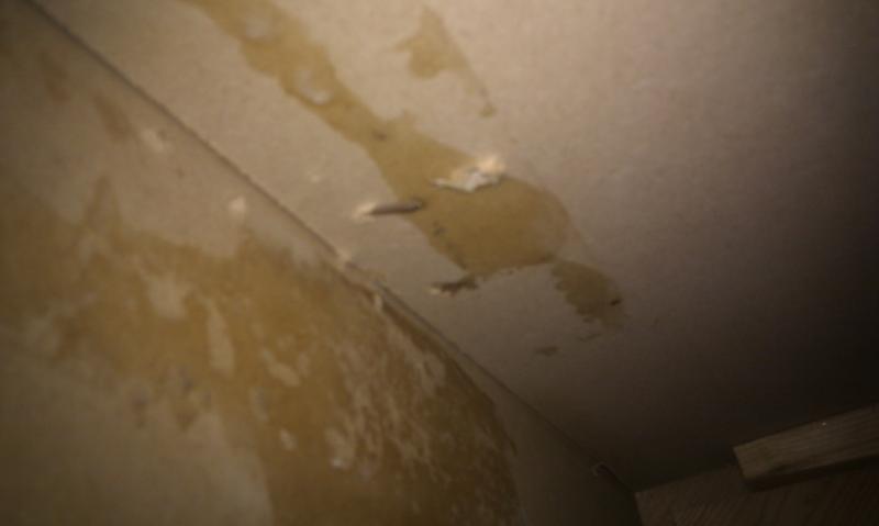

the glue hasnt penetraited the wood on the stairs as the surface is smooth
is it the same on both surfaces
is the risers/treads wood/ply or wood /mdf

I believe that both the risers and treads are MDF.
Here's a picture from the inside of the stair:
You can see that there is some glue there.
mmm mdf is great but not for stairs
i have never used mdf for stairs as its not the best material
its made from wood fibers glued together and as we know glue dosnt stick to well to glue
ok i will have to bow out as i have never made or repaired an mdf staircase :eek:
Can't tell the size of the block from your pics, but it does look a little on the small side.
Traditionally, glue blocks were also screwed to the riser/tread.
Nailing would not be as effective on mdf.
Better-quality stairs are usually made with softwood treads and plywood risers, which are also better materials for screwing the blocks in.
Personally, I doubt you will get anywhere going for the builder or NHBC, that's why I suggested having a go yourself.
