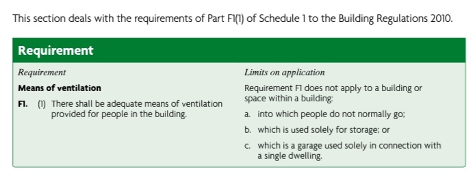

Hi Everyone, When I moved into my current house in 2017 I removed the extractor fan in the kitchen along with the elevated wall cupboards. I don’t need a fan as I don’t fry or boil anything on the stove, in fact I cook as little as possible. A friend recently told me that I am required through the building regs to have an extractor fan and my current set up is not legal. Can anyone confirm either way? Cheers.

All new properties and extensions need to comply with Part F of the building regs
Existing properties are exempt

But to be picky,
The only requirement of Approved document F, is that there shall be adequate means of ventilation.
Which in this case, there probably is!
Keep reading down the 2021 version until you get to 1.15 and beyond on page 8 maybe ?
Yes, that is the "guidance" for complying with the requirement.
In general, the approved document is adequate; complying with the document is the best way to keep building control on-side, but doesn't account for all circumstances.
Approved documents are approved by the Secretary of State and give practical guidance on common building situations about how to meet the requirements of the Building Regulations 2010 for England.
Take for example a passive house may have no direct "extract ventilation" in the kitchen - recirculating hoods are recommended.
