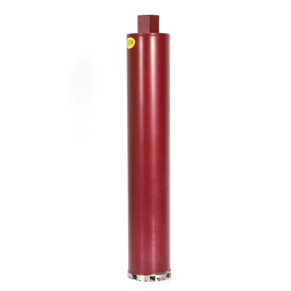

I bought this to make a tidy hole in brickwork.
I have an SDS bit with a thread on it that fits. The problem is, it's impossible to keep the bit in the same place when cutting and it goes all over the place.
Any time I have used a holesaw in the past, it comes with a pilot drill bit that keeps it centred. This is so long, it's not possible. Can someone please tell me how I am supposed to use it?
Thanks.

You are supposed to start a deep hole with a shorter core drill of the same diameter (fitted with a pilot), then once you've established the hole swap to the deeper core drill. It's about the safest way and is the standard way
The fact that it has no slots worries me. If you are going through a 9" wall, how do you remove the core?
I would be inclined to return it for a refund.
Likewise. That will just end up clogging up and you'll never clear the debris from inside. Cheap Chinese tat?
Edit: Correction - looked at the brand, "Futchoy". Definitely cheap Chinese tat. European or American brands are far better, and guaranteed quality - so they are less likely to get failed welds, broken diamonds, etc
Most core drill accessory kits have extension bars which will allow you to go through thicker walls by using progressively longer extensions (my set has 3 extension bars). If you must have a single long bit what you need looks like these (note the side slots - the ribbed sides also seem to run a bit smoother IMHO):

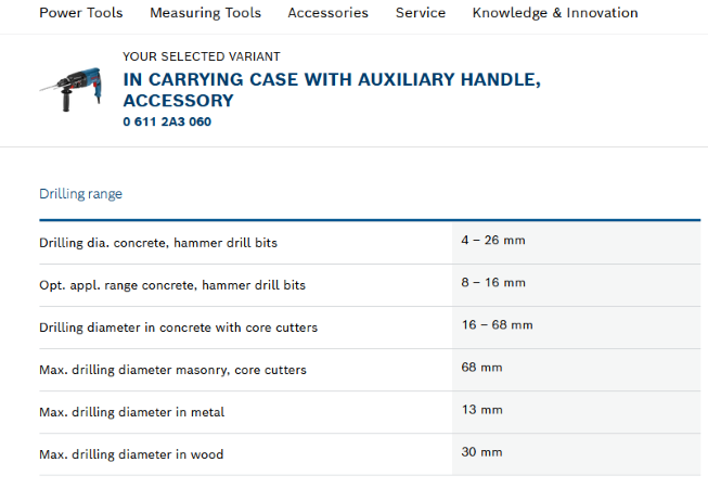

I'm not sure about safe core size, this is the SDS drill I have:
That's a cordless, so I wouldn't even try it as you risk cooking your battery or at the very least having to swap batteries every few minutes (with 3Ah batteries, anyway). Even corded SDS drills can get very hot core drilling because you may be running them for 10 minutes or more continuously under heavy load to drill the hole. If your SDS drill is capable of running core drills the manufacturer should state it on their web site and in the manual, as Bosch do here for this model (Max. drilling diameter masonry, core cutters):
The model I picked is a mid-range 2kg-class corded tool but note that it has only 68mm capacity. Cordless models often have much less power and therefore have a lower (smaller) core rating
Whilst you can drill with an undersize SDS you run a greater risk of a snatch (which will hurt, I assure you) and of cooking the drill or batteries
