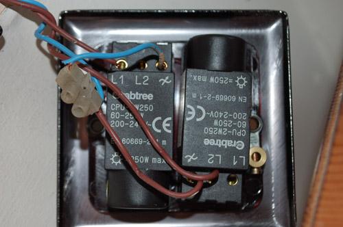

But it sounds like you didn't wire it the same! Is there a strap connecting two terminals (usually C) together? It sounds like that may be done incorrectly.
Tell us what wires went into what terminals on the old switch and what wires you have connected where on the new switch. Pictures are sometimes best.

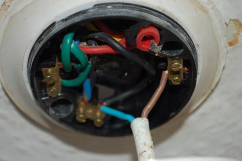

Here are 2 images of the light switch and the ceiling light wiring.
Is there something wrong with the wiring in the switch or is it the ceiling wiring (don't think it would be that but i haven't got a clue)
The blue wire gets split into 2 and goes to the bit with the arrow and wavy line through it (blue and brown wire...that's all i had knocking aroud)

Did you, or did you not, just replace the old switch, transferring all the wires which were there from whichever terminals they were in in the old one to the corresponding terminals in the new one?
And where are the earth wires for the switch? :eek:
The brown wires went to the same as on the old switch.
The blue one went to one and from from that went to the other so it is how the old switch was.

What puzzles me though, looking at the photo, is that the problem you describe would happen if one of the brown wires coming in was the permanent live and the switched lives went out on the other brown and the blue. But the blue going into the choc-block and coming out as a brown and a blue would only make sense if the incoming blue was the permanent live and both the incoming browns were switched live, because you'd never want to join 2 switch outputs into one.
Are you sure you didn't change anything that went into the choc block?

Can I see a brown conductor below and behind the choc block?

The blue wire going into the top right of the switch, looks as if it has been fried!
There's a few nicks in the insulation of the brown wires, and some bare copper on show from that choc bloc - looks VERY close to ending up with a live switch face plate to me :eek:
