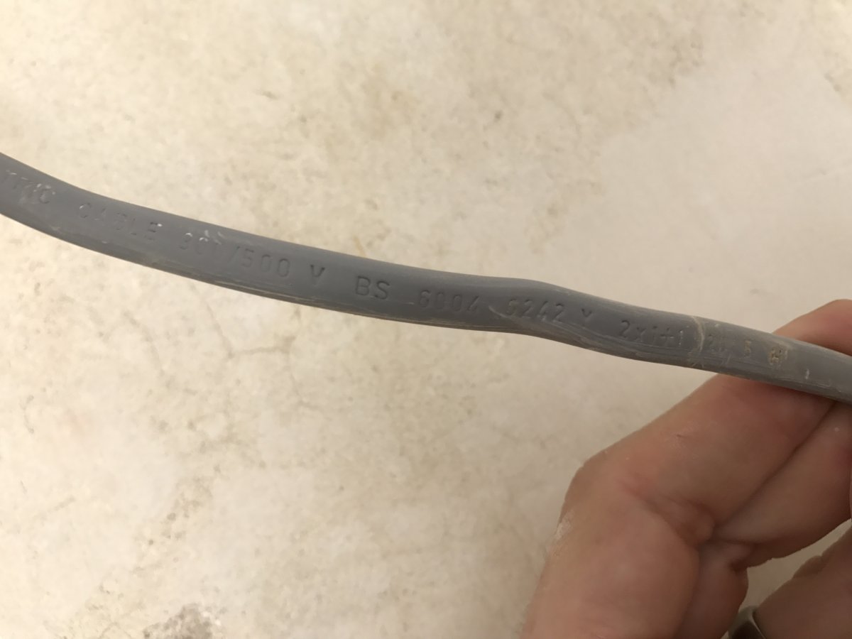

On the 6a lighting radial the following cable is used - can anyone tell what the size is (I think it should be 1mm²?)
As you had the rewire a couple of years ago, you should have paperwork stating all these things.
Then again ...
