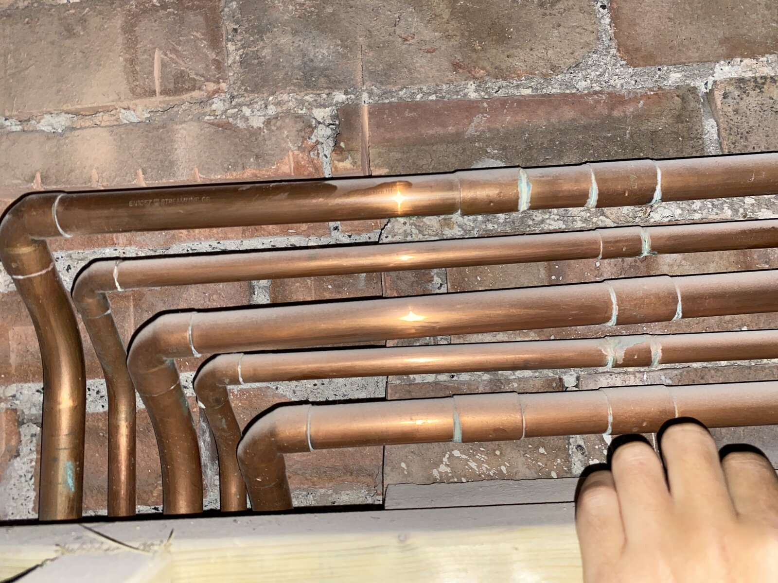

We've just had a Vaillant 830 installed with radiators upstairs and a single zone ufh manifold downstairs. Plumber can't do the wiring so I'm trying to figure out what's going on before I get someone else in.
Everything I've read tells me I should be seeing 2 zone valves but this isn't the case.
Without the zone valves how are our 2 thermostats going to work??

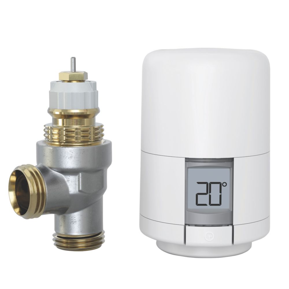

A zone valve does not need to be some thing like this
31480_P
this
968HX_P
is also a zone valve, the first is digital i.e. on/off and has a micro switch built in, the second is analogue and uses wifi to transmit its state.

I wish my plumber was like this. There is no design. Every time he does one job I end up with two jobs trying to fix the things he has decided not to check. I'm at my wits end.
In this case he has installed no zone valves and tee'd off to the rads somewhere under my newly tiled bathroom floor.
The workaround for now seems to be a zone valve for the UFH downstairs and smart TRVs for the rads upstairs. Then it's just a case of chasing the zone valve cable from downstairs up to the loft. That's the only thing I can think of that doesn't involve pulling up the floors.

Upstairs the TRV likely will do all you need, programmable ones like the eQ-3 seen only cost £10 without blue tooth, £15 with blue tooth, so upstairs will also look after its self
