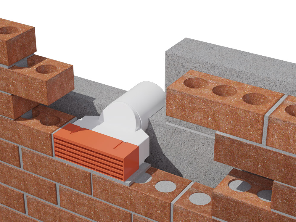

If you reduce the duct size the volume will decrease and increase velocity so it's not advisable. For a 125dia fan the equiv duct would me 60x200 which you can get in PVC, you can also get 'air bricks' that connect up to that so if it's too much bother to core out the opening, you could replace a brick with one of these louvres.
Attached image is an example.
100mm extractor vent would you recommend a 127mm core bit
You might do it with 105. Duct is measure ID+Wall thickness so I think pvc is usally 2mm so 104 OD. 127 will give you extra wiggle room of course.
