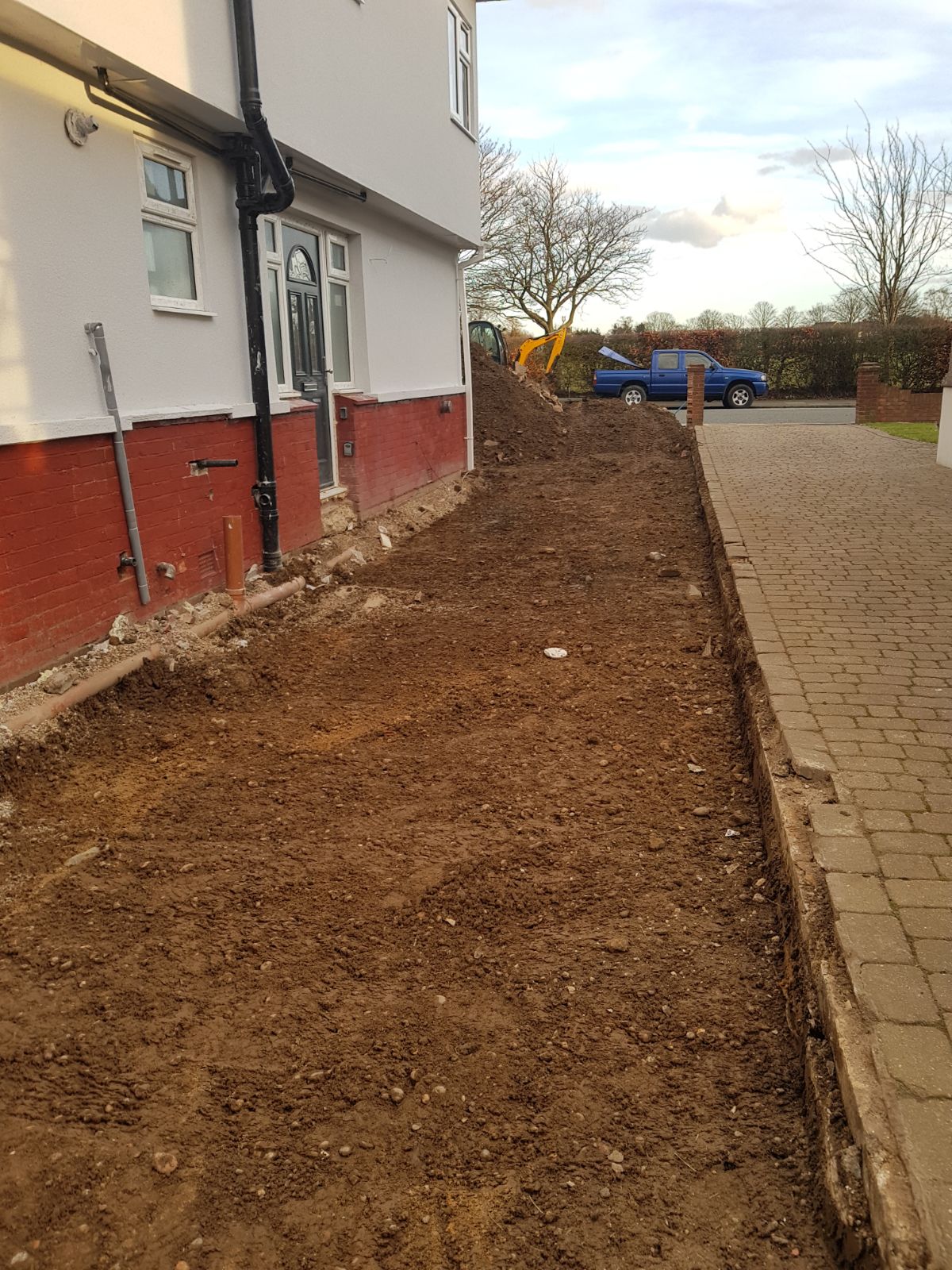

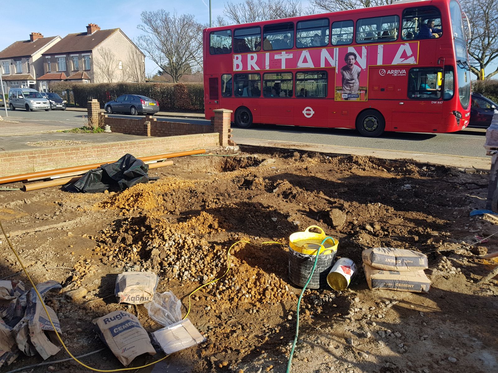

My builder is handling the construction of my driveway, please see attached pictures. From the research that I have done, It has become clear that the first thing to do is the edge restraint across the edges, then the sub-base goes ontop up to 150mm thick.
My builder wants to first of all get the subbase in, compact it and then install the edge restraints which will be done using single blocks of paving laid sideways to create the edge, this will then sit on the concrete bedding.
Please confirm if it can be done this way, his argument is that one doesn't want to be compacting using a wacker near the edge restraint
Thanks in advance.

yes it can be done that way with no problem just scrape back some of the type 1 where its bieng bedded
take a look here http://www.pavingexpert.com/blocks.htm
but dont query everything he does as most people have there own ways with same good results
and it is adviserble to add a textile below type 1 to stop it mixing with sub grade over time
