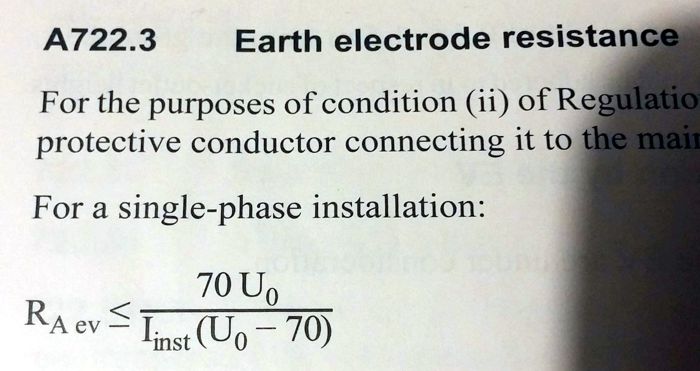

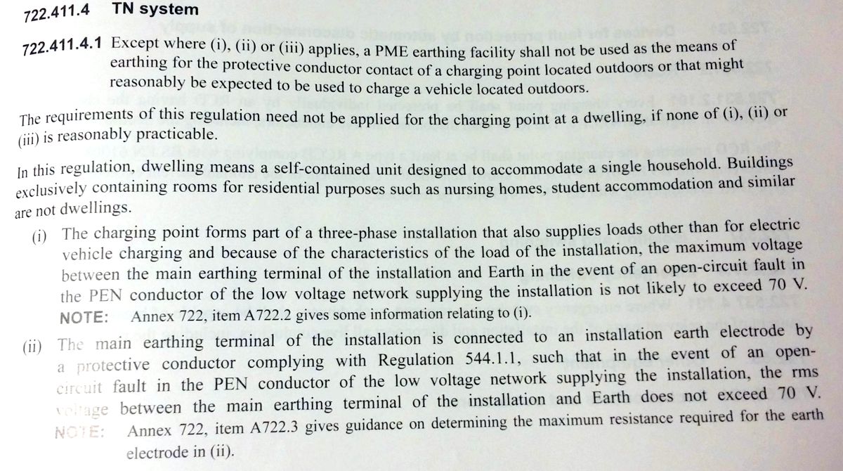

I note that 17th ( 722.411.4.1) specifically states that the regulation "need not be applied for the charging point at a dwelling if none of (i), (ii) or (iii) is reasonably practical"
Note also that in a little over 10 weeks that "reasonably practicable" get-out goes away.

No, I don't think you are missing anything. I think some are perhaps over-thinking this - if they do what you suggest and TT the charge point then all will be fineso long as the earth rod is in close proximity to the vehicle standing.
The 70V disconnect everything requirement is (as I'm sure you know) 722.411.4.1 (iii), which as noted earlier, need not be applied to a dwelling.
