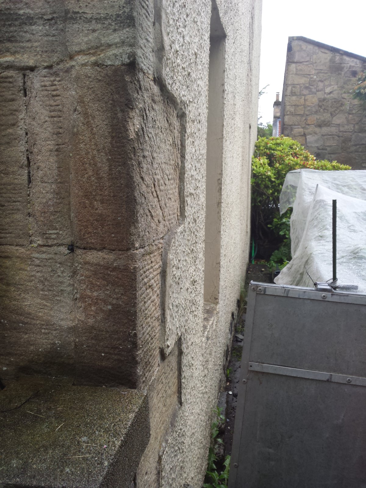

I have recently moved into a sandstone house built in the 1800's, which has a modern extension on the back circa 1980's at which time a cement render was also added to 3 sides leaving just the front wall showing the original sandstone. The render is cracked and boss in numerous places and at some point will need to be redone - although i understand that it should be lime render on the sandstone. I am trying to make a longer term plan, considering other things that need to be done such as insulation etc and as planning won't allow me to cover the front sandstone wall I think that I would have 3 options:

If '3', then this is where I think it gets complicated. Firstly, would it look really odd having the rendered/insulated walls edged off near the front of the house, presumably protruding around 100mm or so, has anyone seen this done?

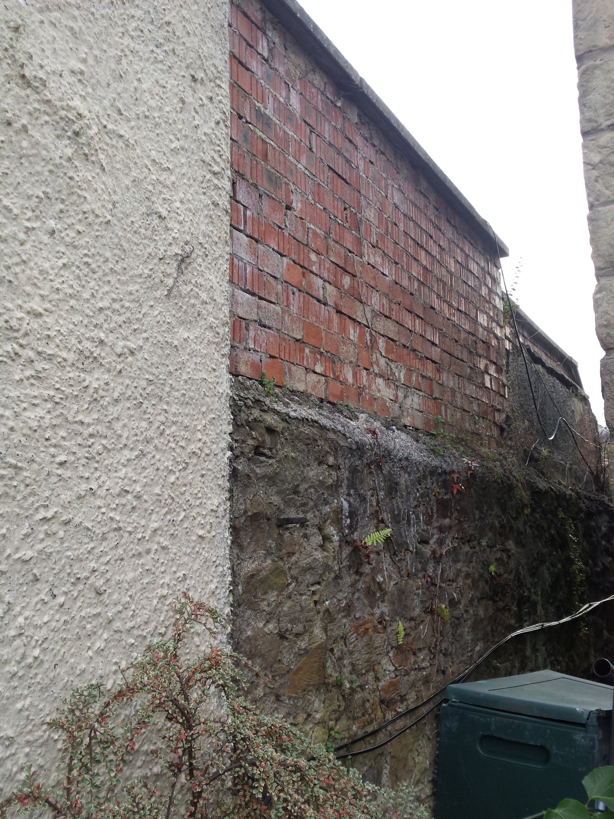

Thirdly, there are some problem areas, such as one side of the extension that faces into next door's garden, that has quite an uneven surface and limited space to work - as per the pic below. I don't know if it would even be possible to insulate here.

Where the render is edged off at the front of the house below:

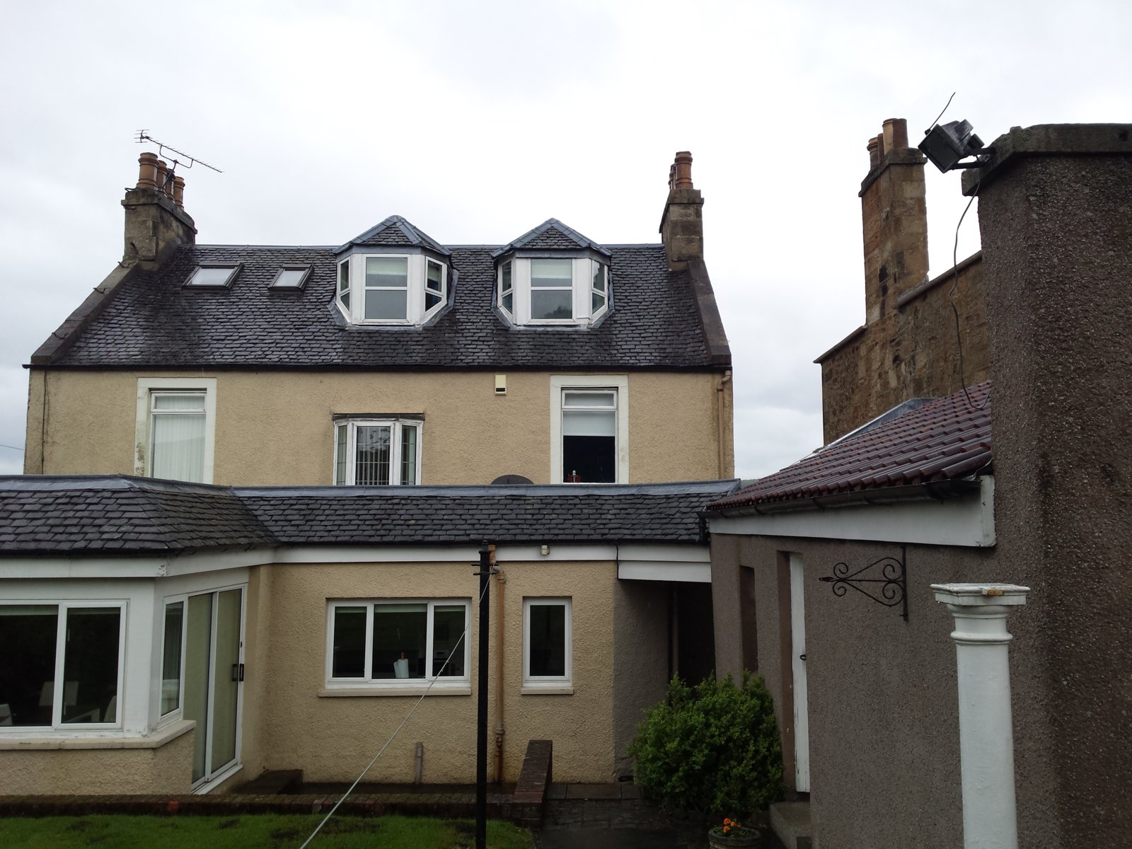

Back of the house showing the 1980's single storey extension:

External insulation also means extending window and doors cills as well any issues caused by reducing roof overhang.
There is no roof overhang or protruding cills on either gable, and I think the overhang should be ok at the back but there could be an issue with the guttering downpipe and the cills on the extension. This has made me think though about how insulation would be handled at the windows because there would still be a significant area of sandstone on the inside of the window recess that would presumably not be insulated. Hmmm not simple.
