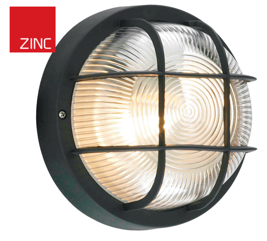

Hi All,
I have 2 external lights that I need to install to light up a walkway at the side of the house. 1 of these lights has 4 1.5mm T&E cables (feed in, feed out, switch, link to second light) and the other light just has the 1 cable.
I brought 2 of these today but am struggling with fitting in the 4 cables:
I can install an exterior junction box but would rather have a light which can accommodate the cables.
Any suggestions?

I've used several Drum Lights from Screwfix.
Possibly this one http://www.screwfix.com/p/asd-drum-light-white-240v/55141?_requestid=554928 though mine have a black base. Inside is a ceramic BC lampholder and a pressed aluminium reflector, the wiring goes behind the reflector and you could use a choc-block if the terminals are not big enough. They have multiple knockouts on the back and I think four knockouts spread around the drum sides, if the one shown is the same.
I'm using them with 3.4W 250lm LEDs candles from Wickes which seem about as bright as the 8W tube I used to use, and ample for a porch and sideway. The big reflector must help.
Why wont it take 4 cables, redrill if neccasary, keep wires clear of hot parts inside, small wago connecters are ideal; for that situation.
A picture of inside the light would have been more help

I considered using wago connectors but can't see it working. There is a tiny bit of space under bulb holder. It can't be outside this as the bulb heat could damage the cables.
Ok, maybe the size is deceiving in the pic, if using an led lamp then the heat is not such a problem.

I appreciate the point that is being established here but for clarity, this is my house (in response to the earlier question) and I have now used 1.5mm cables and there is no going back on this as the cable run is no longer accessible. I am going to look into the drum light but please do let me know if there are any other practical suggestions.
