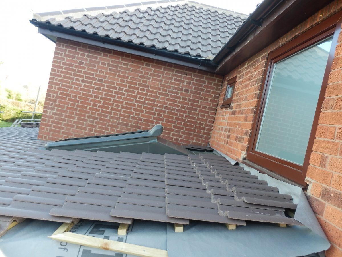

Any body have any expierience with fitting & use of Fakro rooflights & the low pitch flashing kits they sell?
I have a 12 degree pitch roof (due to depth of extension & Bedroom window above), have 3 rooflights being fitted:
http://www.fakro.co.uk/products/all-products/roof-windows/with-increased-resistance-to-moisture/
Normally roof lights only work at 15 degrees minimum, so using a Fakro special low pitch flashing:
http://www.fakro.co.uk/products/all...ecial/for-changing-window-installation-angle/
Would like to know if anybody has used Fakro roof lights and this flashing before? Any reviews most appreciated.
We fitted a 1800mm roof light onto a 10° roof with this kit. It is o.k. to fit and works fine. It does not look out of place from the outside either.

We are using the Forticrete Centurion tile as our pitch is around 11degrees but didn't want to use their small expensive windows. I have done some research and I am also looking at the facro flashing kit and window, so any advice would be much appreciated.
Many thanks.
The extension has been finished for 3 years. We have used Forticrete Centurion. Our roof light is 1800 x 780 with electric opener and shutter. No problem so far. The only condition by BC was to double rafter the window.
