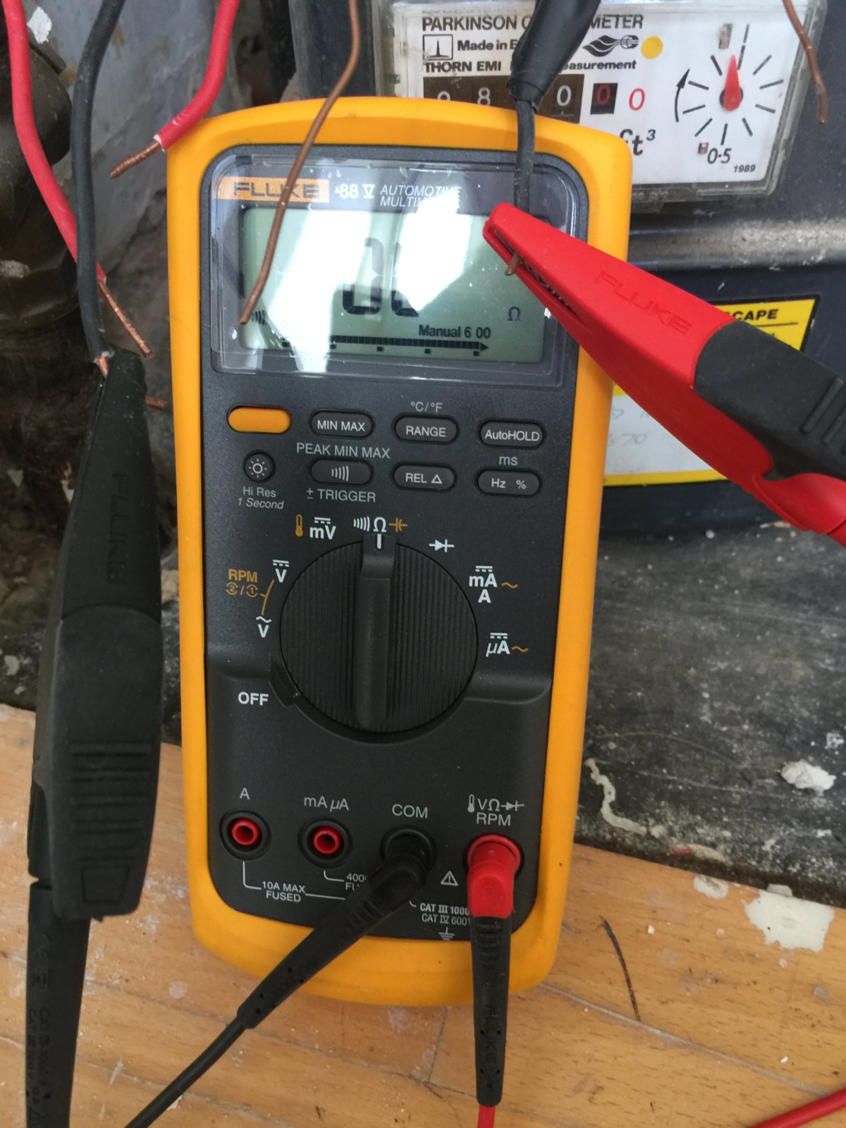

The puzzle,
Thank you all for replying, I did not explain clearly enough, so one of the ring ends is tripping the RCD, I have removed both cables from the MCB, This is what is get,
From the cable that is tripping,
Earth has continuity with the other cables live and earth, not neutral.
Neutral has continuity with live and earth, not the other neutral.
Live has continuity with live and earth, not neutral.
On its own the bad ring cable, all live(red) earth and neutral (black) all have continuity.
On the other earth and live have continuity...
Are wires swapped around or trapped,
Thank you all again for the help.

Have you also removed the two neutrals and two earths from their respective bars in the consumer unit?
T... one of the ring ends is tripping the RCD, ...
If only one of the ends is tripping the MCB then the ring must be incomplete. If you have ruled out things not connected properly at the sockets on the ring, that must mean that the cable has been 'chopped' somewhere.
I presume you mean that all three have continuity with oine another. If that is the case then, as I said before, the cable must not only have at least two of it's conductors broken somewhere, but something must be shorting them together (on the CU side of the break). Drills and screws would seem the most likely culprits.
Are the heads of screws that you have recently pout into the walls all 'accessible'?
As EFLI has said, you should remove the neutrals and earths of the cables concerned from the bars in the CU (as well as removing Ls from the MCB) when you measure - although I doubt that would alter my 'interpretation' above.
Kind Regards, John

Guys... I’m back and thank you all, it was something really silly I did.....the said socket..
I joined them with a wago 77-106 6 terminal!!!! I thought, and don’t laugh, the the terminals joined parallel, so red to red, black to black and so in... not all together.... I wonder why they don’t make one, instead of using 3 separate 22-412 double pin. Regards x
There's still a potential issue there- both legs coming back to the CU should have shown the same fault (everything shorted out). They didn't, therefore your ring is not complete. Well worth sorting out while covers, sockets etc are off
