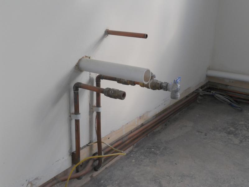

Most manufactured units are about 570mm deep and are designed to fit against the wall. The backs are generally inset about 40 to 50mm giving enough space to run water pipes (normally 15mm copper, although you'll sometimes find 22mm in a few kitchens) and waste pipes (normally 38/40mm in the UK). So the hole cutter sizes you'll find useful are 20mm and 44mm. Doors are mostly about 18mm thick and standard worktops are 600 or 615mm wide, leaving you with very little margin to set the units off the walls, in fact if your walls aren't all that straight you may find yourseld hacking away plasterwork to accommodate the units (at least in old houses this can be so). There is, of course an exception - IKEA kitchens which have no back recess at all. On those the pipework all needs to be dropped to within 150mm or so off the floor, which is the distance from the floor to the underside of the cabinets.
As to heights, I've found on replacements you are often limited by the existing pipework, after all why replumb an entire kitchen for the sake of a few feet of pipe? The only thing I'd recommend on heights is that if you are replumbing drop the waste below the water pipes and make sure that you can get access to stop taps, isolator valves (every wate pipe to every appliance, including the sink needs one of these), plug sockets, etc Also remember that many washing machines and dish washers don't have the space behind them to accommodate waste stacks, so these need to be behind the unit next door. The same goes for plug sockets (and in that case includes ovens, built-in fridges/freezers, etc)

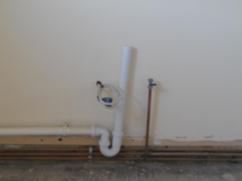

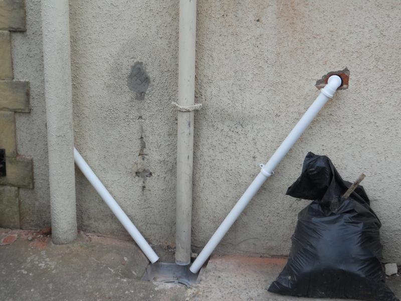

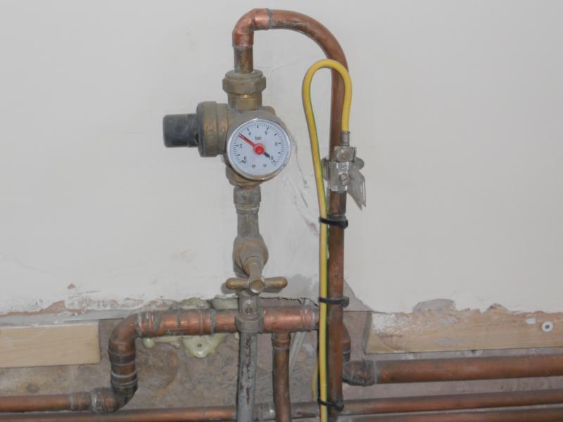

other pics of kitchen plumbing ready in place etc ready for kitchen to be fitted and service pipes brought through backboard at sink etc + drill a large round hole with a holesaw for the main stoptap & another for the prv dial...all this look ok ? or is anything else i need to consider cheers again :)
do my heights look at the correct height..(pipe going through the wall is for the outside tap)
