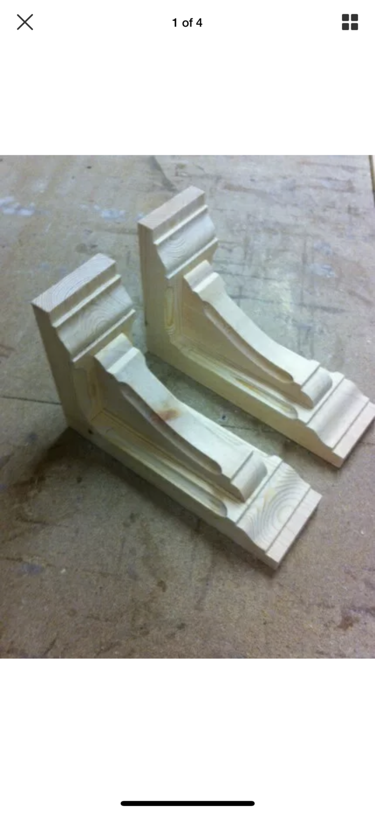

is there a proper way? Want to add some small 8” corbels the the underside of the gable end. More for aesthetics but I suppose will offer support to.
I can see how gallows brackets could easily be screwed due to them having an accessible back, but corbels are solid. How do you go about fixing in place?

Sorry, wooden corbels. The gable end extends 8” over the wall. A very small canopy.

You think? The barge board is going to be wood as are the exposed rafters. I’ve already signed up to painting maintenance. Plus I think they will be in keeping with the 20’s house.
in that case no problems. you can fix prepainted corbels in position by screwing throufgh the barge boardan slant screwing thro predrilled holes in the corbels into wall plugs with say 75mm x 10's galv screws

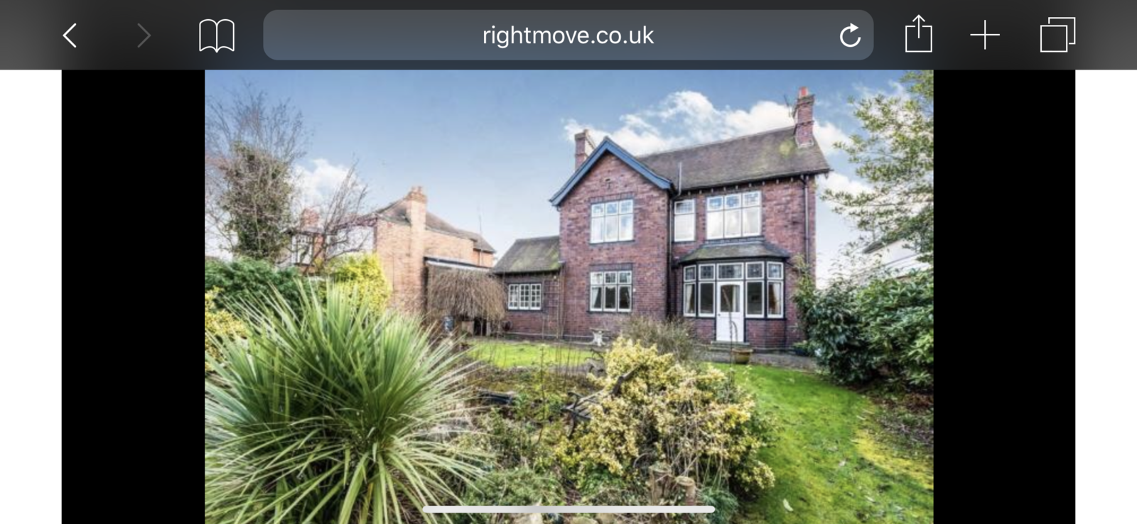

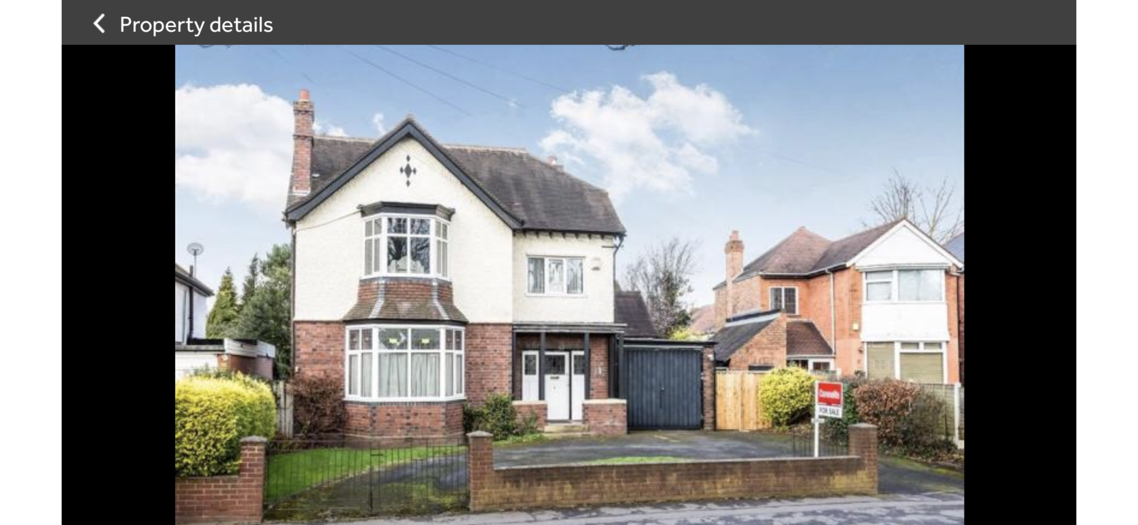

I would suppose it would be classed as Edwardian style even though it is slightly after the true Edwardian period being build in 1925. But I imagine the style carried on after the Edwardian reign.
What do you think building style wise? Photos from estate agent pics a year ago. You can see the outhouse on the right side that I’ve removed to do the new extension.
