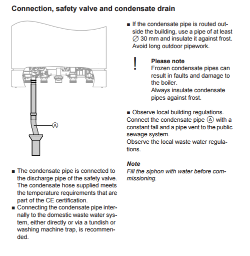

Looking at the boiler installation manual, based on the above, I'm not totally sure the way the condensate is currently fitted fits with the instructions:
With my install: (A), the supplied flexible condensate hose, is pushed onto the condensate pipe that was already there from the old boiler (solvent welded stuff), albeit now cut down a bit above the work surface i.e. the solvent welded pipe used to connect directly to the old boiler, but (A) now connects to it, above the work surface.
The pre-existing condensate pipe then runs down through the work surface, along the back of a unit, and joins the washing machine output in an adjacent unit and on to the outside - there's no trap, the washing machine outlet is pushed onto a spigot at the end of the pipe, and the solvent-welded pipe connects to the same outlet, from above, a little further along. It's the join to the washing machine output pipe in this unit where there's a drip leak - it doesn't leak from using the washing machine.
AIUI, even though it's a minor leak with how it's currently connected, I'm not meant to touch this as it forms part of the flu? Also, the pipe outside isn't lagged - is that required if the condensate is combined with the washing machine outlet?

Keeping in mind Jackrae's comment above, the instructions posted are all I can see in the online manual regarding Viessmann's recommendations for condensate drain connections.
The Viessmann does seem to have an internal trap though - listed elsewhere in the manual.
Given the above: if it leaks again, and I have to get them back to look at it, is the sink waste spigot an acceptable option for the condensate?
From the above diagram, it would appear acceptable. A tundish is an open vented collection point and the diagram states that a tundish is acceptable or a direct connection to a sink waste.
