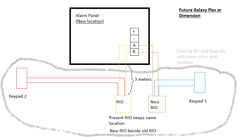

I would like to move the new panel to 3 m away from the present location. Can I just add the wires with some kind of junction box or connector (I´m not good with soldering) or it is recommended to replace the whole wire (some are around 30 meters long)? That will be mainly for one keypad and external siren, since I will keep the existing RIO in its present location and just wire it to the new panel location.

It may be easier adding a second plastic Rio at the existing panel location if it's not easy to replace or extend the existing cabling. I would normally try not to have joins or junctions, but if you have no choice, then done properly, it will be okay.
Something like this?
