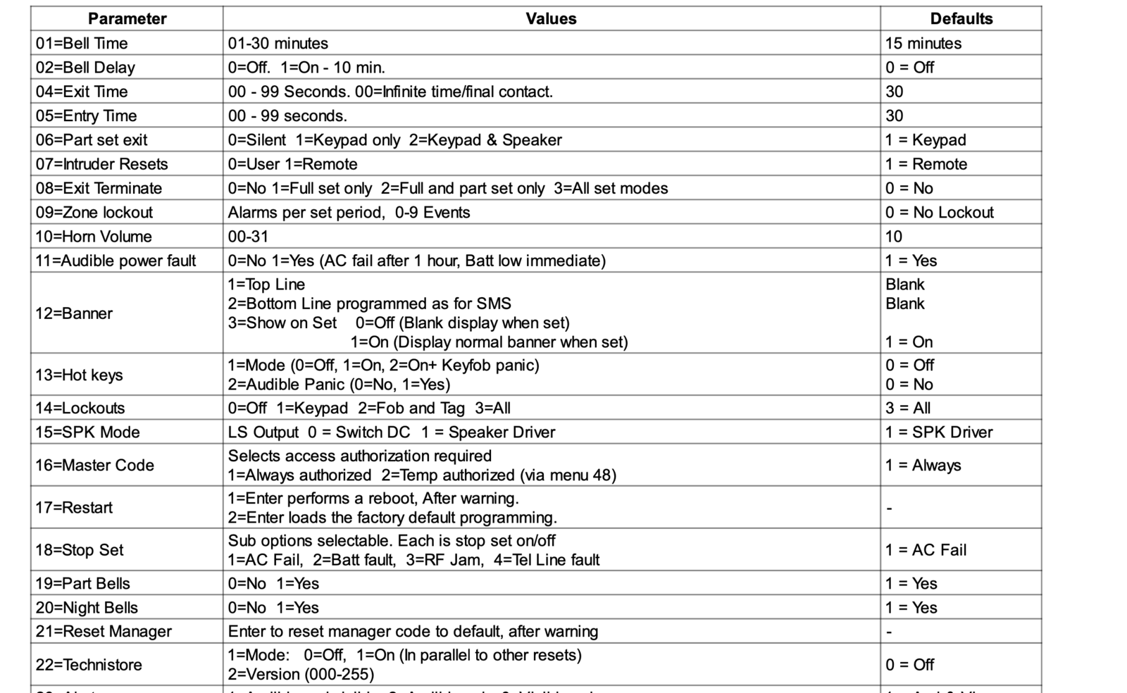

I had a question about the part bells and night bells setting in 51 parameters.
When the part set and night set has been activated and a zone is opened and the unsetting timer counts down from 30. If 30 seconds pass, only the internal sounders goes off, the outside Bell does not activate. Its this normal? Ideally I want the bell to activate also it it could be an Intruder.
Any advise is greatly appreciated.
Engineering menu 51.19 and 51.20 need to be set to 1.

Okay gents, so I've figured out what the issue is.
Night set is activated and completed. The Front door contact and the Hall PIR are final zones . Someone enters from the front door. The 30 second entry time starts. After 30 seconds no pin code has been entered & the internal sounder goes off for around 30 seconds. Then the bell box activates outside. Is it normal for the bell box to go off after 1 minute of entering the property from a Final zone, the 1st 30 seconds is the countdown, but should the alarm by design wait an additional 30 seconds after the countdown has finished to activate the bell?
Regards
Amz
The alarm is functioning as it should. Bells will sound if the entry timer expires unless the bell delay us enabled. If the users don't have enough time to switch off, then increase the entry time.
