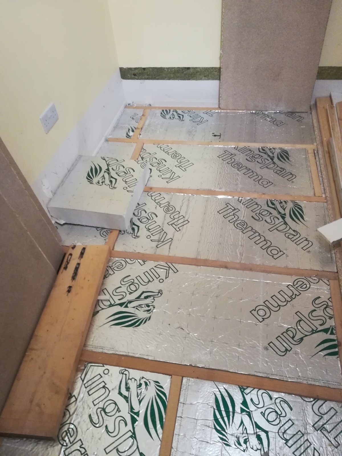

I've put 100mm Kingspan down for the floor and I have another sheet of it set aside for the inner leaf. The Room was already converted when we bought the place but they had put a stud partition across the back of the garage door without properly insulating it and the floor was sagging, I lifted it and put the floor back down with the new insulation using most of the original materials.
I was hoping to get the Building warrant retrospectively and been taking photos along the way, am I likely to get crucified for that?

Crucified no. Financially punished yes (fee for regularisation is usually double the standard fee). If you're doing the job properly then put a building notice in and if you're lucky you'll get helpful advice from the BCO instead of them poking and prying to find fault
