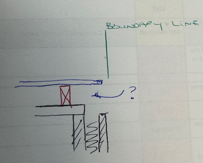

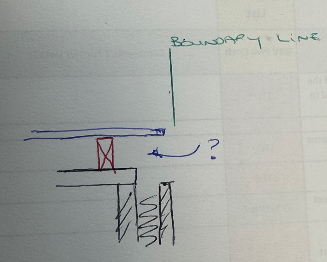

I'm however unsure how the last roof joint of the flat roof should be detailed. It is important because i intend to built the garden room as close to the boundary as possible.
I have attached a quick sketch. Can anyone offer some advice on how the roof structure should be closed so support the edge of the roof deck and facia board?
Should this be done with a flying rafter in line with the external skin?
