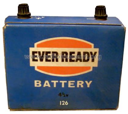

A few months ago we replaced an old Bakelite bell which the bell and the chrome striker external to the unit. However, we never had a transformer because the bell was powered by an Ever Ready battery with 2 terminals on top. I'm sure that this battery was 12v. Can't remember even looking at the details on the unit.
Edit: wife tells me it had Bell or Bell Battery printed on the side.
These were the very common 126 battery 4.5 volts. The light in our toilet used one of these when I was a very young child.
http://www.radiomuseum.org/r/ever_battery_126.html
