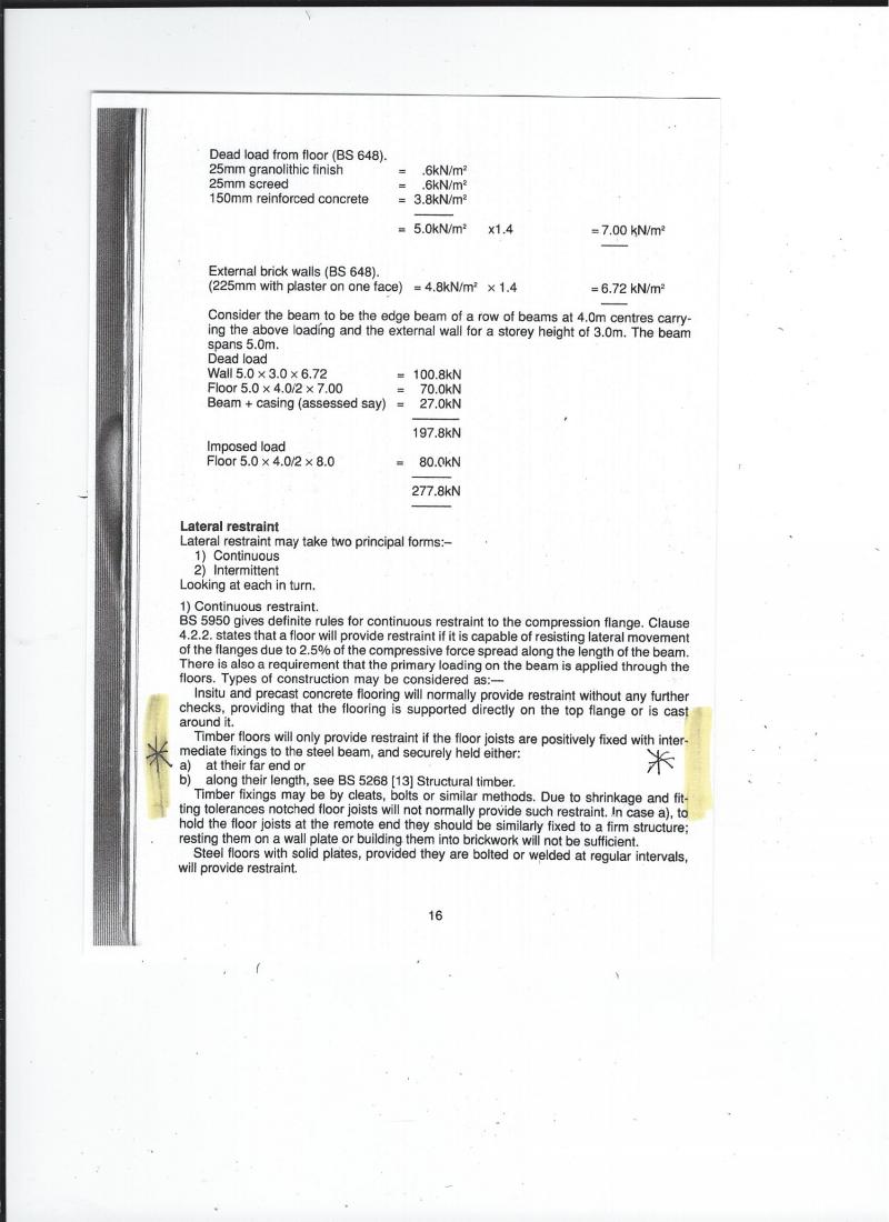

Lateral restraint of a beam
In the Borough Council's view, this restraint could be provided by locating and fixing the beam tightly underneath the floor joists"
From the Handbook of Structural Steelwork
Full (continuous) lateral restraint is provided by:
(i) in-situ and precast flooring or composite decking, provided that the
flooring is supported directly on the top flange or is cast around it.
(ii) timber flooring, if the joists are fixed by cleats, bolts or other method
providing a positive connection.
(iii) steel plate flooring, if it is bolted or welded at closely spaced intervals.
If the beam isn't fixed in place (bolted or similar) then it can't be considered to be fully restrained.
Not sure there are many engineers who would treat that as fully restrained without the above, especially one without PI!
I'd usually take at least 1.0L for the effective length in such a situation, although where I used to work the partners were more conservative than that.

The loads look about right. The only difference is I allready included self weight of beam so that was in twice. But removing it doesn't make a significant difference.
Regardless of the restraint, in my opinion the beam is perfectly adequate. BS5950 is really way over the top on safety factors and realistically you will never get anywhere near the total loads the beam is actually designed to take. In fact Eurocode 5 is available now and standard calcs on that are bringing in beams typically at least a serial size down on 5950. I'd like to bet a re-calc would show a 23kg beam in your situation. Unfortunately I don't have the EC5 software at present so I can't check it. (but I will do in the next week or so)
