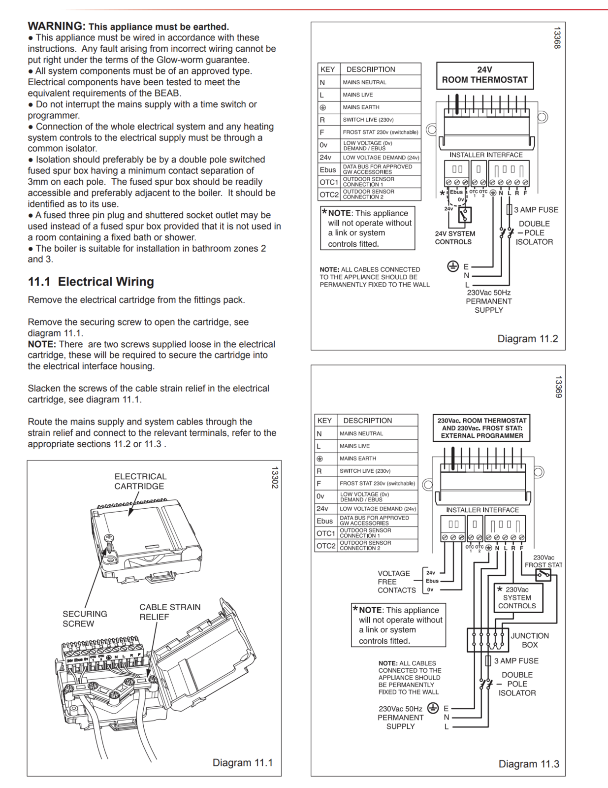

Can the OTC1 & OTC2 connections on the Ultracom 1 30cxi be used to connect to the OT1 & OT2 on the google nest heat link in order to enable openthem?
The boiler engineer who fixed a few issues for me previously has installed the system but only connected the boiler using the on/off functionality. And there is currently no wiring utilising the OT1 or OT2 on the heatlink. I've called glow worm and they seem to think it may work but were a little hesitant.
Does anyone know if this will work? Also if this is possible can someone suggest the wires i will need to use to do this?

The OTC connections are for Outdoor Temperature (IE weather) Compensation, not OpenTherm
