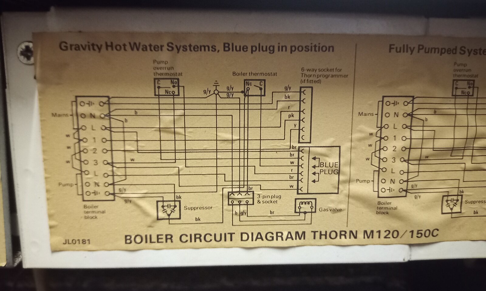

I am looking to Install a nest 3rd Gen onto a Thorn M120 / 150C.
The hot water tank is currently not used, just the central heating so only looking to control that (but will set the hot water up if possible)
Currently the boiler has a remote room thermostat (to be removed) and a mechanical timer with the 'heating' 'off' 'water and heating' options.
I have the instructions for both boiler and nest, I've fitted nest before to several combi boilers which was straight forward enough but this seems like it may not be as straight forward.
Any ideas of wiring connections?
Will be running all new 4 core (or whatever needed) for the heat link and the nest thermostat is going on its standalone USB power.
Could you be more specific on the type of system? Y plan, S plan, C plan, W plan? What timer is it? Sounds like could be gravity hot water.
I have VERY Limited knowledge to be able to answer that but I believe it will be Y Plan as one of the switch positions is 'water and heat' and the other is one of those only. There is a hot water tank connected on the floor above so I believe the hot water system is gravity pressure if that's what you are asking?

Definitely not as straight forward as a combi.
From attached I'm going with it being a gravity system as the blue plug is connected (second diagram out of shot shows red plug for 'fully pumped')

Given it's age and the system I'd assume 60% efficiency (and it could be worse)...and a properly installed modern combi maybe as high as 95%.
Should've been swapped out 20 years ago....it's so old it doesn't appear on the SEDBUK efficiency website (and that's decades old now).
Completely pointless adding silly smart stats to such old junk.
