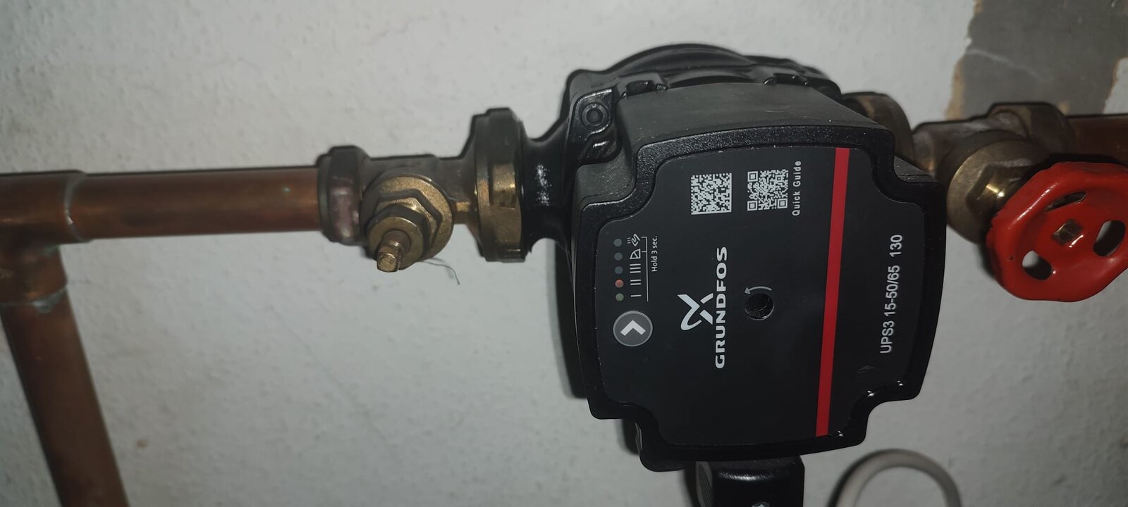

I had a new install for a pellet boiler just over two years ago. We're off-grid for gas and it seemed to be a good replacement for an aging and inefficient oil boiler.
The lingering problem is the noise of the pump and it's associated pipework, which is located in an upstairs bedroom cupboard. The noise is not the pump itself, but the noise of the water flowing through the pipework attached to it.
If replacing the pump doesn't work is it possible to locate the pump outside? Not exposed, but in the ground floor external structure that I built to house the boiler., are there any downsides to this?

It's a Grundfos UPS3 15-50/65 230V
How do I find out its mode and setting?
Regards
Tet
Take a photo of the LEDs while running, (and post), you can see below what mode&setting its running at.

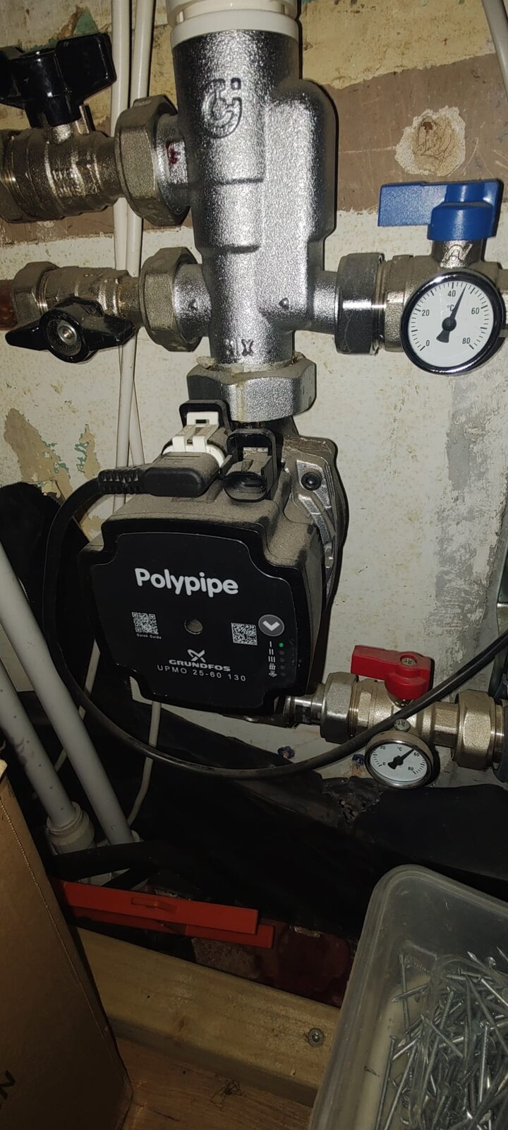

The offending pump is set to CCII per the above diagram. (see attached) This pump is for the six upstairs rads and the HW tank
Downstairs is a polypipe-badged grundfos UFH and the second pic shows that this is set the same. This is almost silent in operation

CC2 will circulate at over 5.2M head, should be no need for that head with 6 rads, suggest CP1 at 3.0M, if too weak, suggest CC1 at 4.2M.
