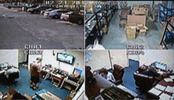

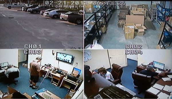

These are mock-ups showing the kind of picture change I've seen in higher resolution to interlaced video conversion.
Detail and text becomes difficult to make out. Diagonal lines become jagged with a staircasing due the the signal being interlaced. Forget about running the CCTV display in split screen mode. The resolution of the mini images will be terrible after conversion. Run as full screen with alarm recording. That way you'll get a half decent iage from the cameras that matter.
The final conversion to RF will add a little noise, but if you choose the output channel carefully then it can be quite close to video quality.
