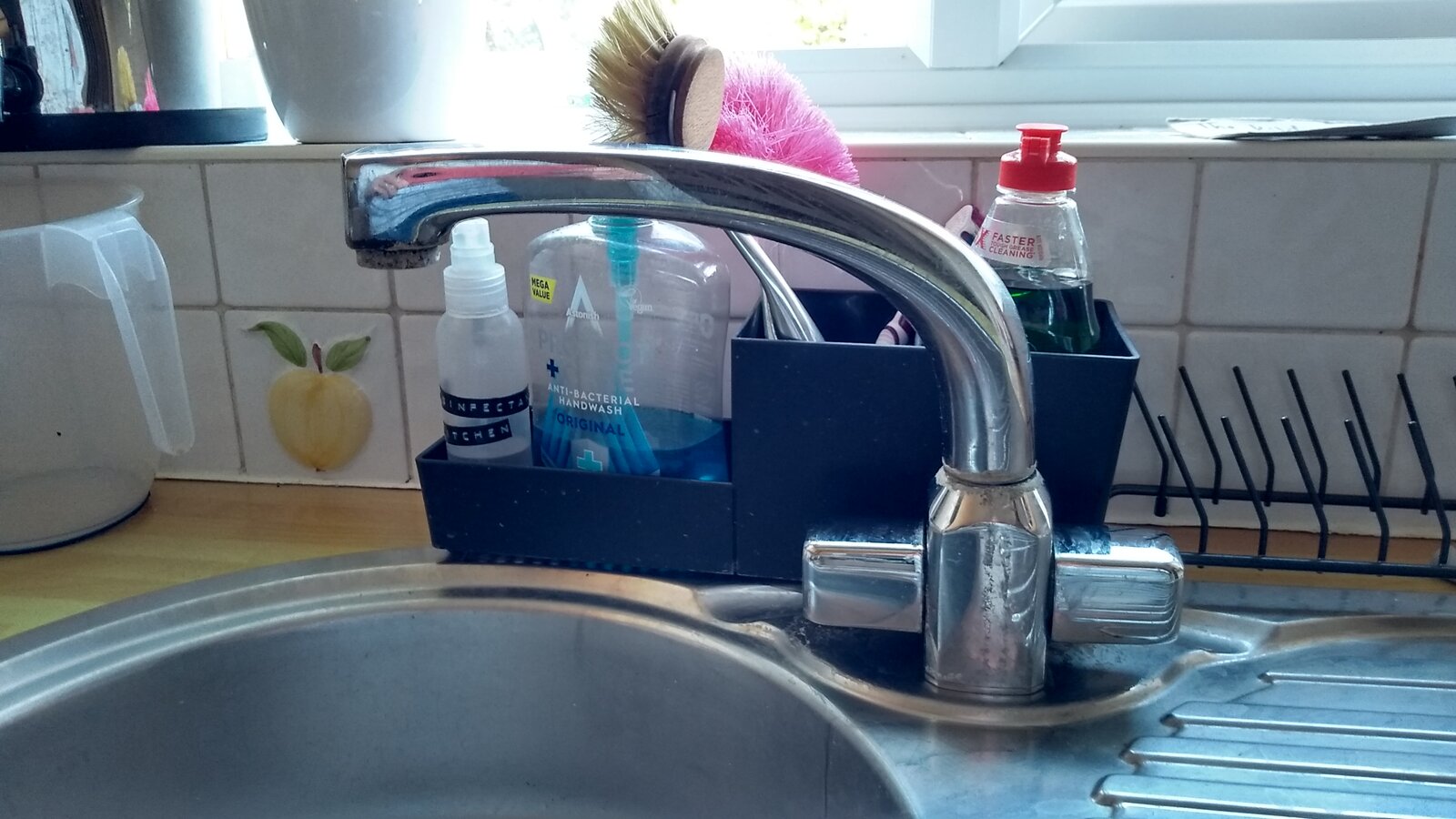

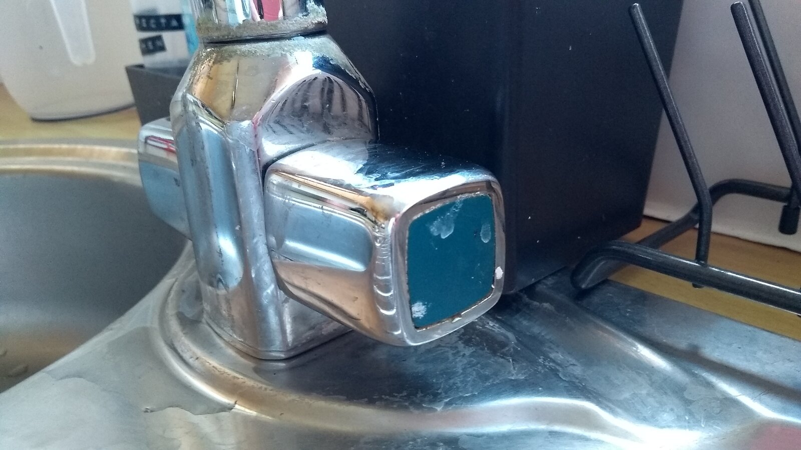

Here is the tap. It is leaking from the spout to body - as you can see. I may just try replacing the o rings in there. The spout is also wobbly. IMG_20220916_100922804_HDR.jpgIMG_20220916_100901012.jpg
Flat blade screwdriver into that plastic shaft . New tap will come with new tails or flexis so just snap existing ones out the way

I removed the spout and the two o rings were completely knackered. I managed to find an O ring from my big box of o rings that fit gave it a smear of the proper silicone grease and when I left the leak was fixed.
1 point with my O ring set is that out of the 32 different sizes I never seem to be able to have the exact right size - so frustrating its a kit just like this one https://www.amazon.co.uk/HFS-Universal-Assortment-Metric-A
It was an R12 but the fatter version was too fat and the thinner one that I used seemed a little too thin - I needed something in between -- ahhhh
