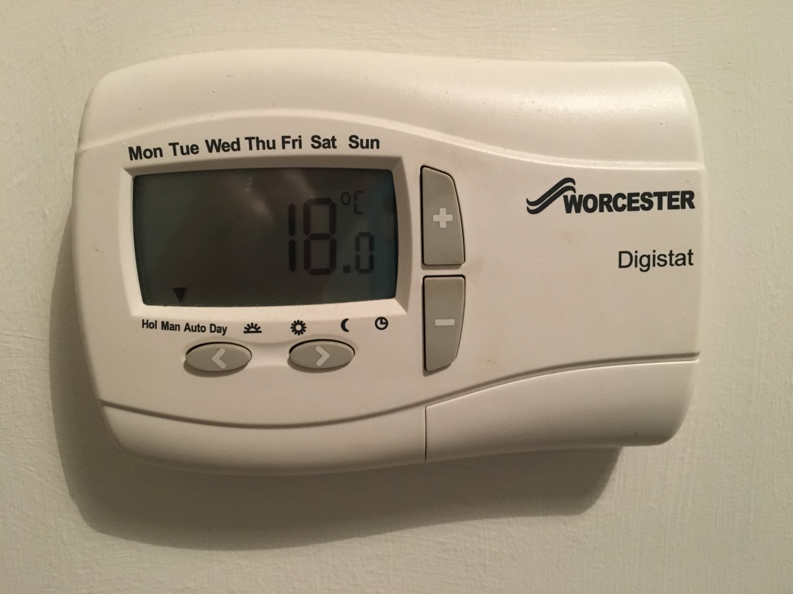

Hi everyone.
I am looking at getting hive and getting it installed by a engineer but on amazon and other places they have a heating and hot water model with installation or heating only.
My boiler is a Worcester greenstar 30si mk3. The boiler is in the attic and we have a remote thermostat on the stairs.
Can anyone help me with which is the correct one to buy as I can’t find it online.

you need a single channel hive, but not straight forward , does your boiler have a D20 receiver fitted to the boiler
I don’t know about the d20. That thermostat is battery operated.
I’m no good with boilers I just know which one I have and that we want hive. It just dosent help amazon dosent list single channel etc

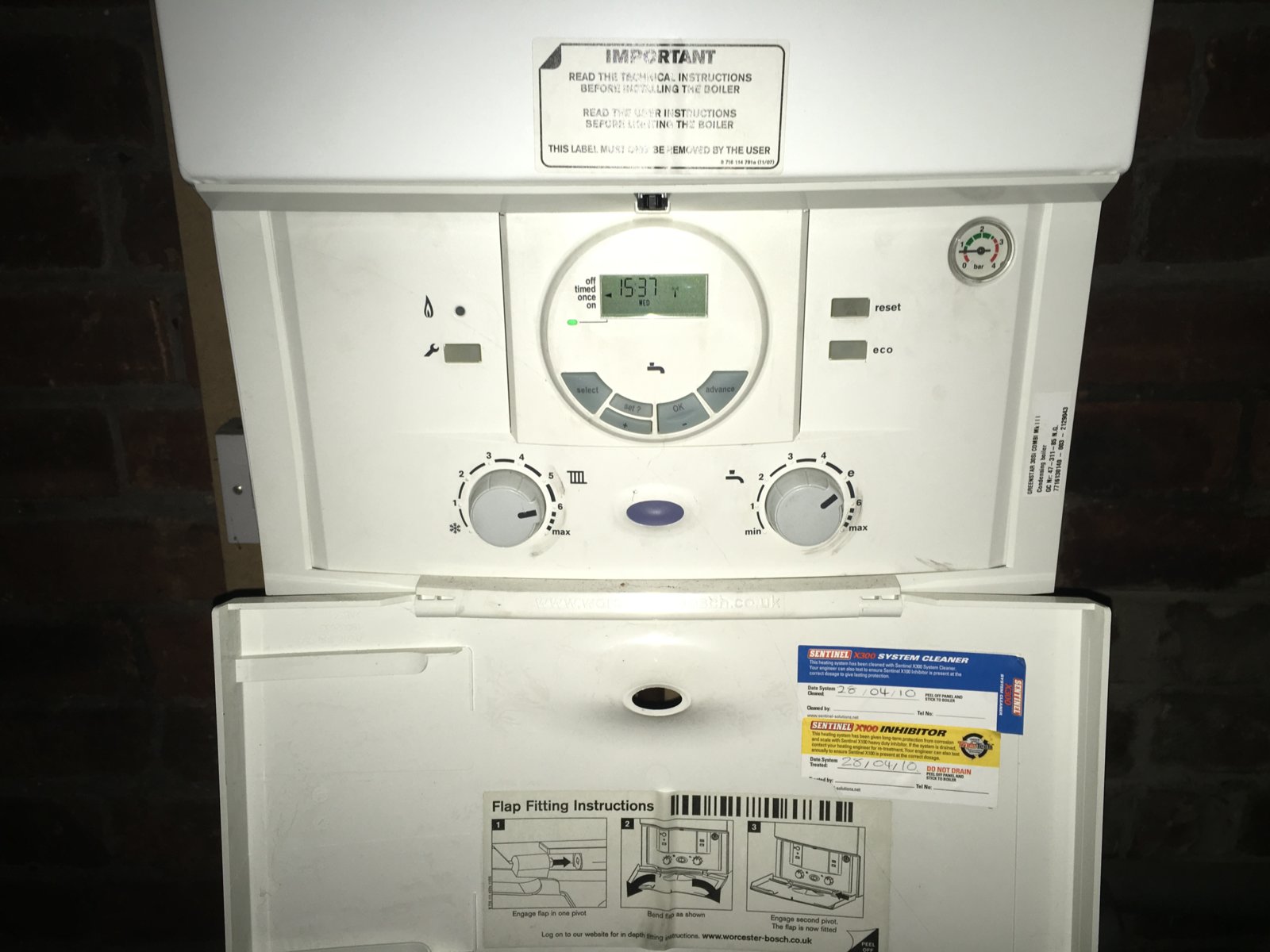

yep that is a D20 you will have to disconnect the wiring ribbon from that once the new stat is installed, no need for any link, to be honest not really a DIY job , might be better if you get a pro in @stem pm me if you want more information , I know you like your nest and hive

you do not have the same boiler if you are looking to install a hive CH and HW unit as this boiler is a combi and if you are trying to install a hive CH and HW unit you have a system or heat only boiler, they are not the same thing
Thanks I will top up the pressure. Yeah the reason I was asking with amazon is it’s £80 cheaper for the ch and hw with fitting than just the hw. That’s why I was wondering if I can use it?

yes on your boiler it can be but you are lucky, if your boiler had low voltage switching it wouldnt , CH on from the hive to LR on the boiler
Lucky escape then I hope, just to confirm the boiler I have is a Greenstar 30si and comes with a DT20RF PROGRAMMER and wireless room digistat (clicky wheel type design) so will I get away with using the hive active heating and hot water thermostat or should I get the heating only to be on the safe side. Thanks in advance
