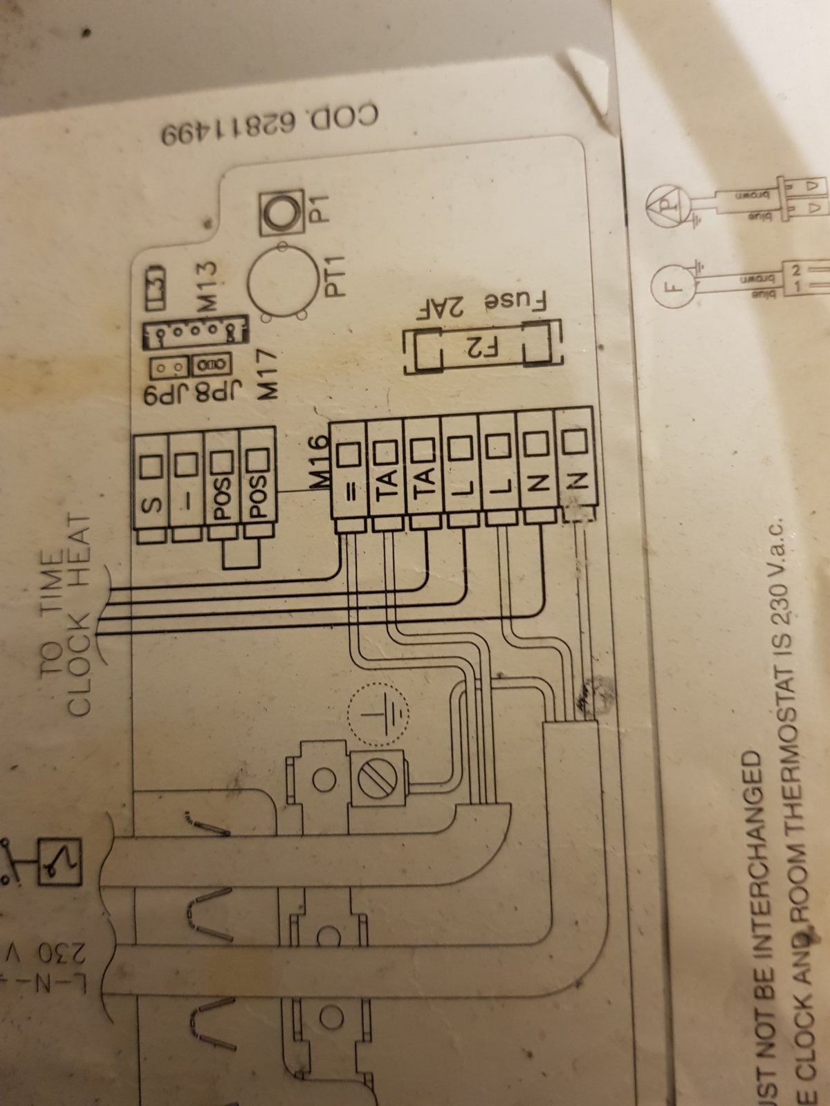

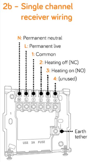

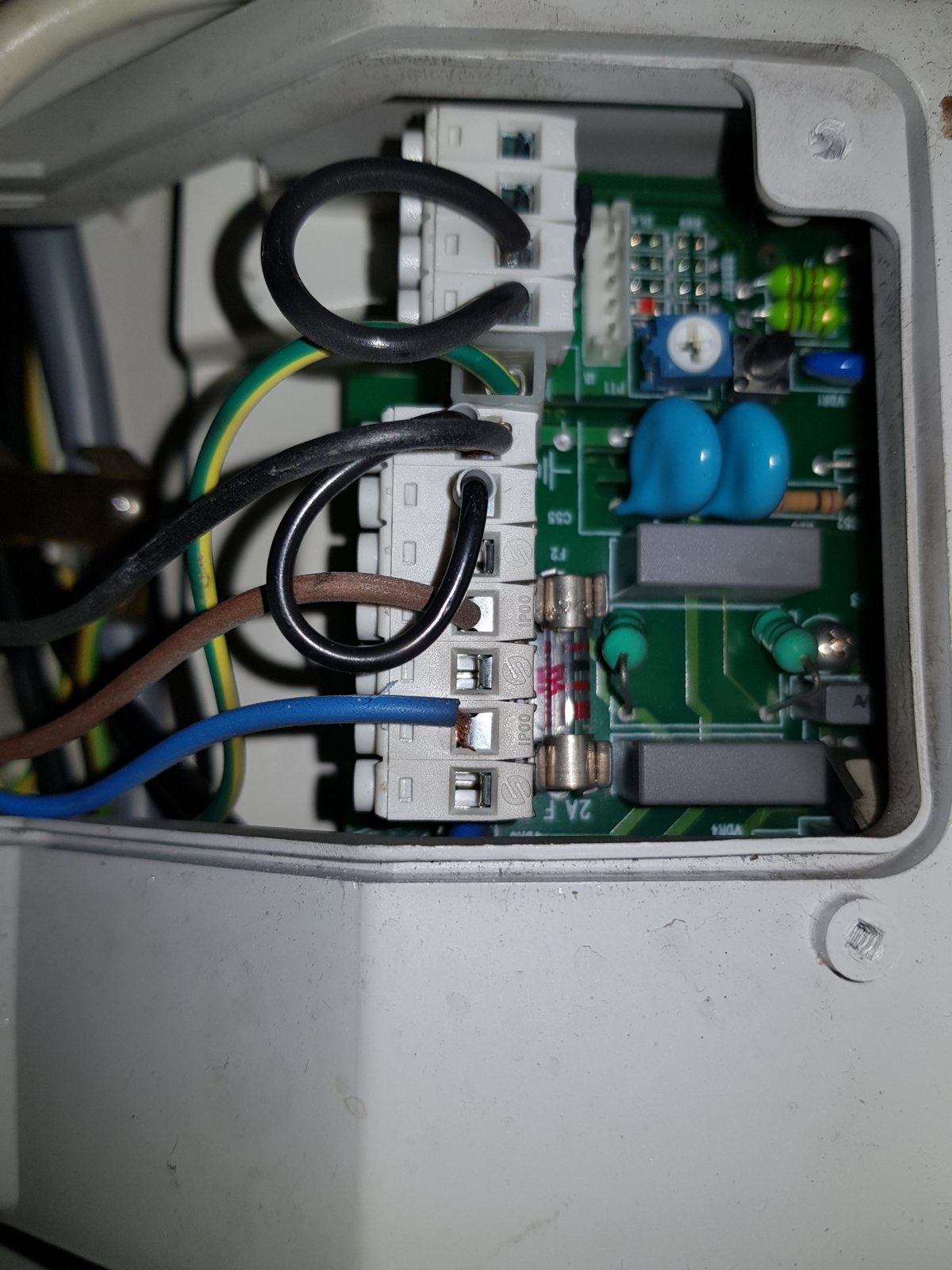

I'm trying to install a hive thermostat. I was able to get the hive receiver hooked up but I think I've made a mistake with the wiring as the heating will stay on continuously.
Can anyone tell me what needs connected to what?
I've attached the boiler board (It only has the old timer connected in the picture) and the two diagrams for hive/boiler.
Cheers

In the main when fitting off/on thermostats some link needs removing from boiler, with better quality modulating thermostats often you don't need to remove a link.
With modern gas boilers most modulate so need a modulating control, with oil they often don't modulate so need a off/on control, easiest modulating control is the thermostatic radiator valve (TRV).
