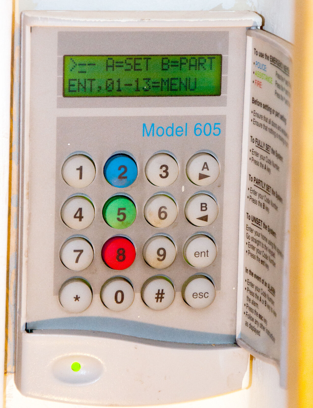

My first question is whether the new panel will be compatible with the two existing keypads (which are marked 'Model 605', and I assume were installed 20 or so years ago, at the same time as the panel), and/or if anybody can recommend replacements for the keypads that do not cost the earth? I am looking just for keypad functionalty, not fob / promximity detectors.

I'm not even sure what a model 605 keypad is. It will probably work with the Flex, as the protocol hasn't changed. You'll be able to pick up used non pros CP037 keypads cheap enough. PM me, as I have new CP037's.

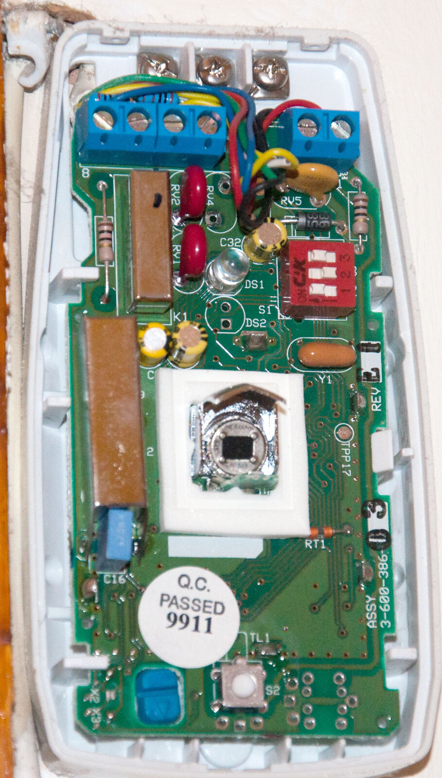

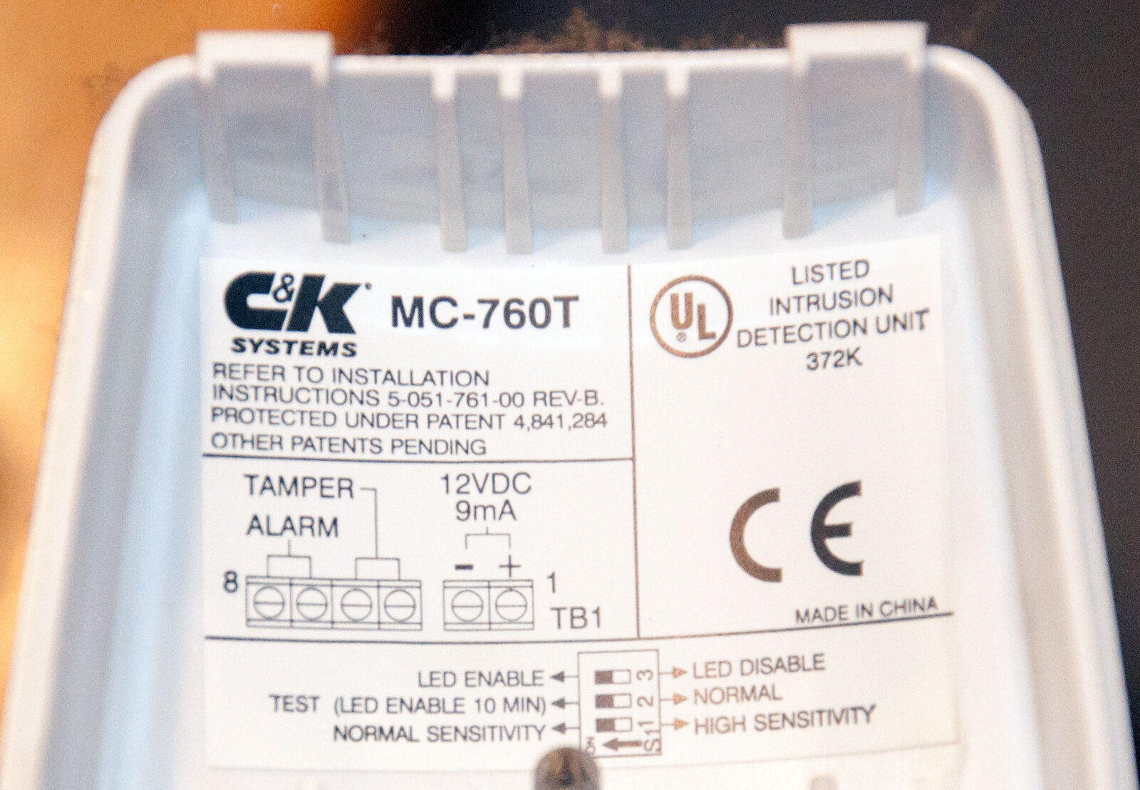

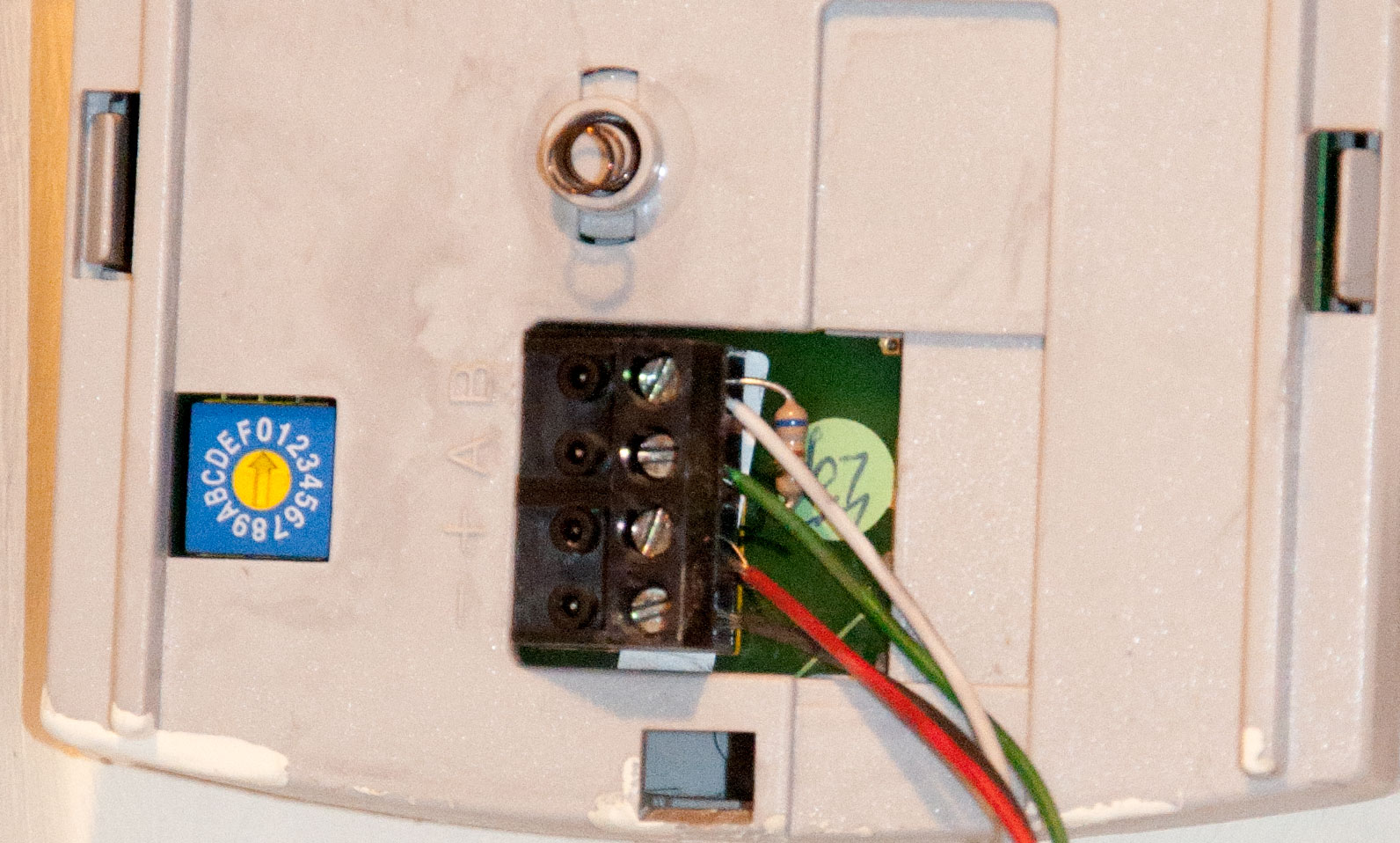

Attached are pics of the Model 605 keypad, and its rear connections, also the PIR innards and nameplate.
You advise adding resistors, presumably one to each PIR. Please can you specify where / how to add, and what value resistor I should use?

It looks like your system is already configured for double balanced circuits. I see the resistors at the top of the sensors. So you should be ready to go. The only way of knowing if the keypads will work is to try them connected and then boot the panel.

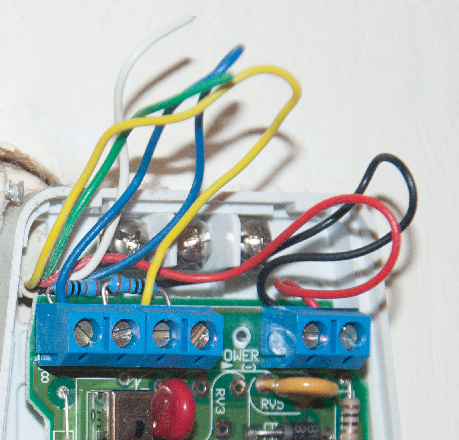

Thanks for the advice on the wiring of the sensor and how to use the spare strands. Inside the PIR that I've looked in, the 12V and 0V terminals are connected, but two additional cores of the cable are connected to the sensor terminals, as shown in the photo. This differs to your note that just one wire should used per PIR, so I'm just wondering whether this is a problem..

Your wiring is fine and pretty much standard. One of the blue or yellow cores will be 0v the same as the black core Ie. going to the same copper on the panel PCB. If you need the core for something else, you can disconnect in the control panel and just link the black over in the sensor.
