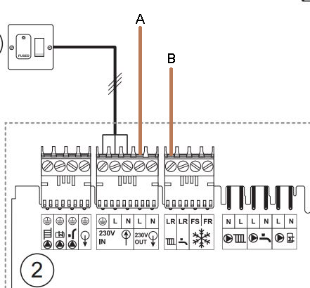

Hi,
Not an electrician but after some advice please!
I have Worcester Bosch Greenstar i and have been given a Honeywell T6R Smart Thermostat.
I'm after some advice of how to wire it in to the heating terminals on boiler (power is fine) and which cable should be used?
I've attached the boiler electrical diagram and the lyric wiring instructions - if anyone could advise that would be great.
Cheers
  • lyric-t6R.pdf
  • Greenstar 25i Electrical Diagram.pdf
Instead of wire from Boiler L to A - you might link L & A at the receiver box.
Ordinary flex will do.
