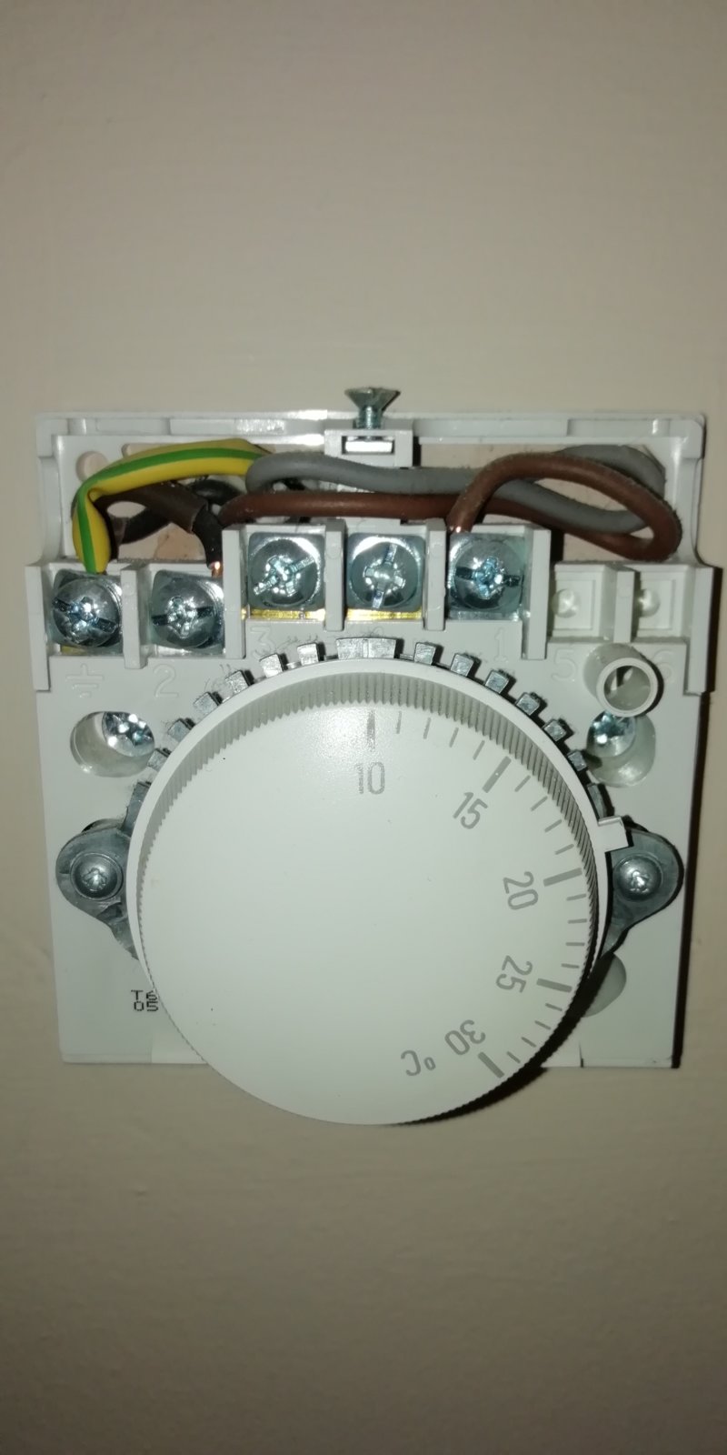

I'm changing my Honeywell T6360B thermostat for a Salus RT310 but am struggling to understand how the Honeywell is currently wired. The Honeywell website states
1 = Live
2 = Neutral
3 = Switched Live
but if you take a look at the attached photo the wiring doesn't match this. There is a brown wire to 1, a brown sleeved black wire to 2, nothing to 3 and a grey wire just folded up at the top.
Would appreciate some advice!

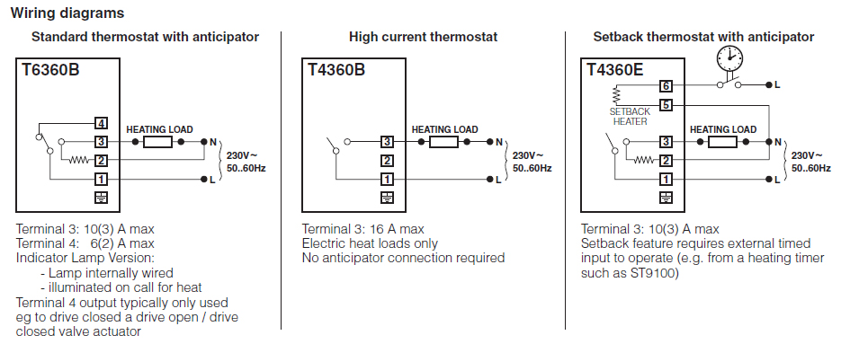

https://heatingcontrols.honeywellhome.com/Documents/Installation-Guide/pdf/1151.pdf
I don't know for sure which model you've got, but it looks like it is connected (1) and (2)
not (1) and (3)
However if the system is currently working and the thermostat turns the heating on and off (DOES IT?)
then the two wires that are actually connected to the terminals must be the live and switched live.
If it doesn't currently work then all bets are off until you work out what the wires do.

Yes, if the heating is on at the boiler the thermostat works as expected. I'd assumed that 1 was the live and 2 the switched live but can't understand how it's working as 2 is technically the neutral terminal?
2 and 3 are connected together, through a small resistor which warms up as current passes through it.
The thermostat doesn't need a neutral.
The wire must be heating load, or the stat wouldn't turn it on. It's not really the neutral, it's "neutral after it has passed through the heating system controls" which in your case is near enough for it to work.

OK, so I've used my multimeter and the wire at 1 has a permanent 240v. The wire at 2 has 0v with the thermostat not calling but once heating is called the reading goes up to around 45v. Does that seem right, being an amateur I expected to see 240v at the switched terminal once heating had been called.
I can see where the wiring goes into the boiler but I'd really rather not start to open it all up!
If I'm understanding the Salus wiring I need to connect live to COM and switched live to NO?Also need to terminate the unused earth and neutral wires?

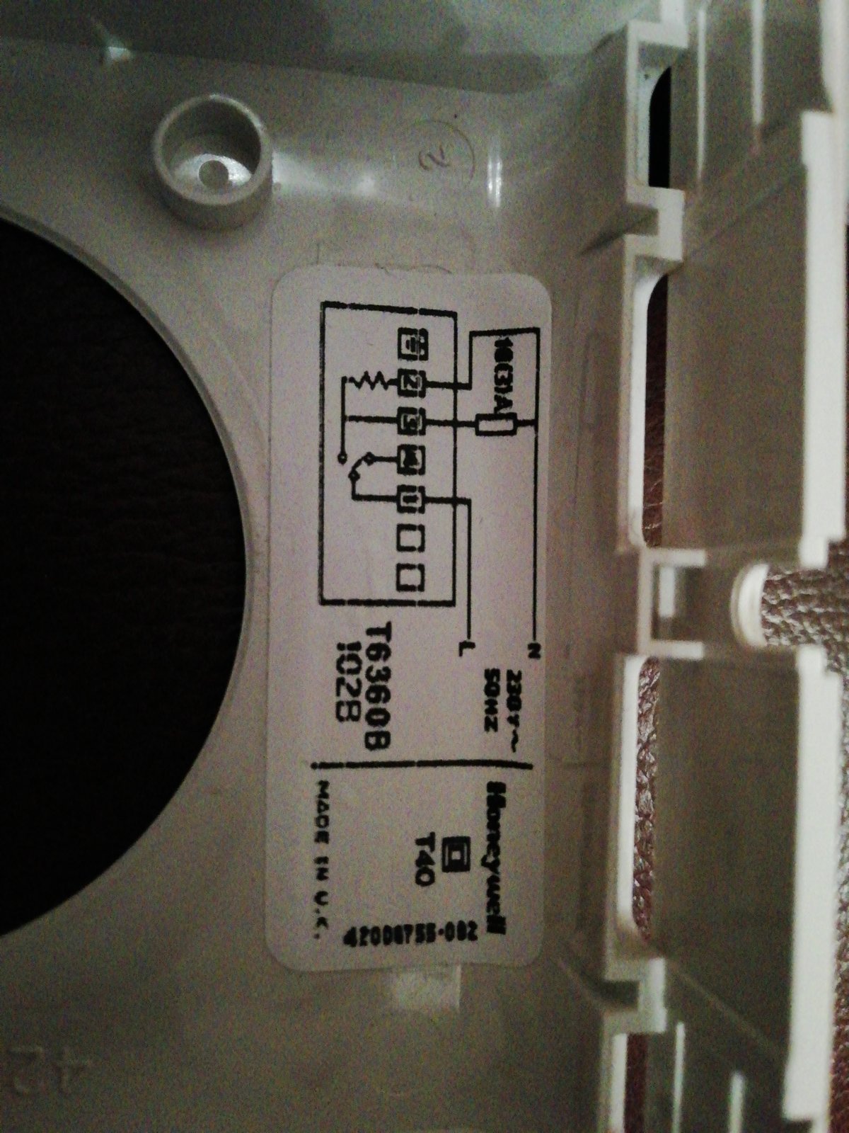

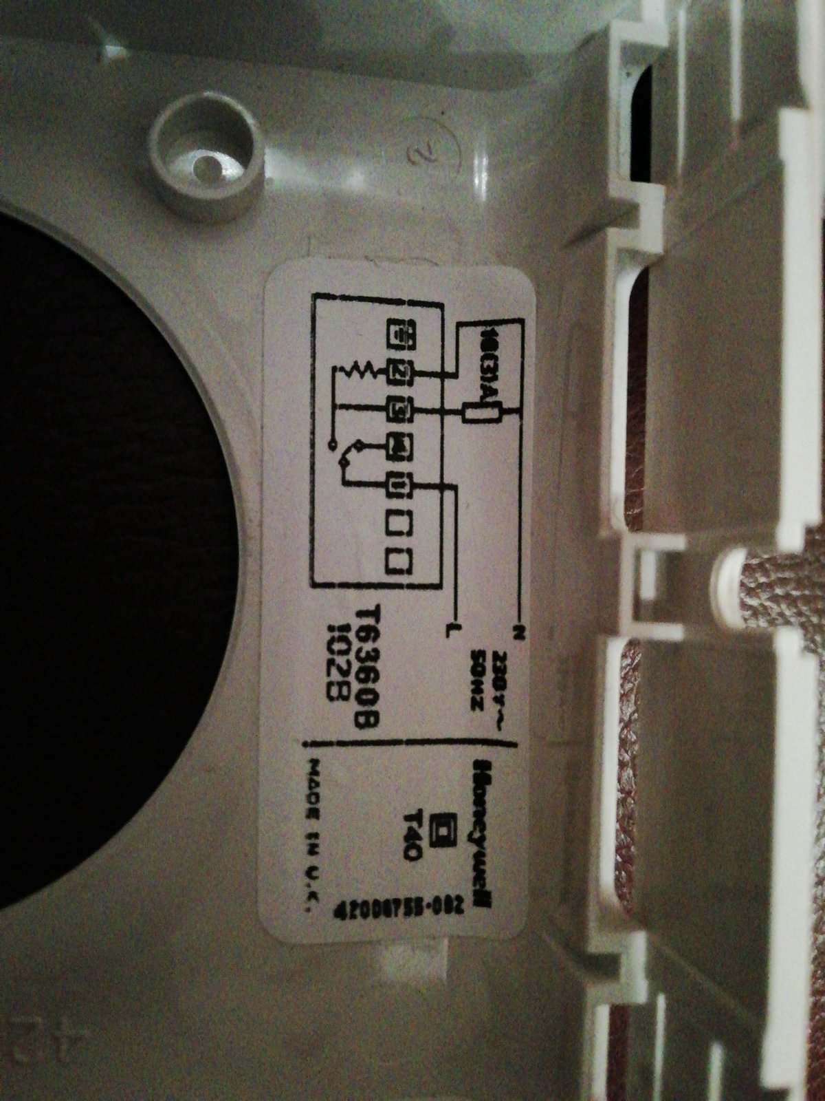

It seems a thermostat that looks like the Honeywell T6360B can have different internal connections, it seems likely it is connected 1 and 2 on first diagram instead of 1 and 3 due to voltage measured, however to change without being sure why it was wired that way I would not personally do without checking the connections in the boiler.
Does this help?
Some boilers have the thermostat connected to a lower voltage either 24 (off/on) or 48 (modulating) and my worry is some one may have connected to the extra low voltage bit of the boiler, it is unlikely, however possible, so I would want to check what it is connected to on the boiler before telling you to correct the wiring.
