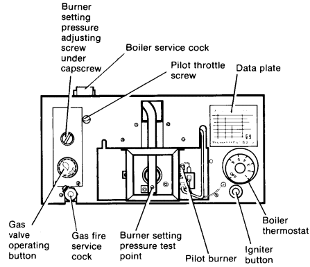

Hi,
I turned my Housewarmer Economy 45 off for a clean, and when I tried to re-light the pilot light it won't stay lit.
Here is a diagram showing the pilot start buttons:
The procedure for lighting is: Push the Gas valve operating button-press the Ignition button and hold for 1/2 minute. The pilot lights up ok, but goes off when the Gas valve button is released.
The gas valve button, also twists clockwise. Why is this? Does it need to be twisted when holding?

Try holding the gas valve button in for longer after the pilot is alight ,gives the thermocouple a bit longer to heat up.then release it slowly.
Hi T,
5 Minutes, still no good!
Can you clarify, about the Gas valve button. Are there any connections inside it, or is it just gas channels? What difference does twisting it make?
C.
Not too familiar with mysons range of housewarmers ,but the principle is the same on pilot ignition . some you turn the thermostat to off. Then press and hold the gas valve button ,this manually opens it allowing gas to flow to the pilot .pressing then the igniter creates the sparks which then gives you the pilot flame. This flame heats the thermo couple ,which then generates a small electric charge ,sufficient to keep the gas valve open. After 30 to 40 seconds. You then release the gas button. If the pilot goes out then the thermocouple is suspect.is it possible you may have disturbed it when cleaning ?? One end has to be in proximity of the flame and the other end is affixed to the gas valve. After a failed attempt to light the pilot ,its usual not to try again for three or four minutes. As the pilot is actually lighting then the gas valve button that you press is doing what its supposed to, unless the pilot flame is extremely weak ( small / low ) compared to what you have seen historically.

Hi,
First I noticed that the pilot light flame wasn't directly aiming at the thermocouple, because there is a tube over the pilot light that had corroded. Bought a new one, but didn't fix it.
Next I tried the current from the thermocouple, as normal, 10mV with an added flame 30mV, so I think this is ok.
Next I tried the resistance in the Gas valve, nothing, so now I suspect the Gas valve.
C.
Or possibly TMV/pilot flame/TC connection...
Hi W,
Do you mean the thermocouple to gas valve connector?
I took out the thermocouple relay, and there's no continuity, between the contacts.
C
