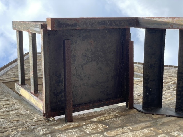

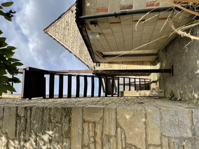

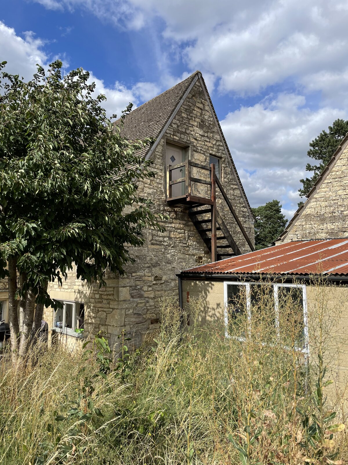

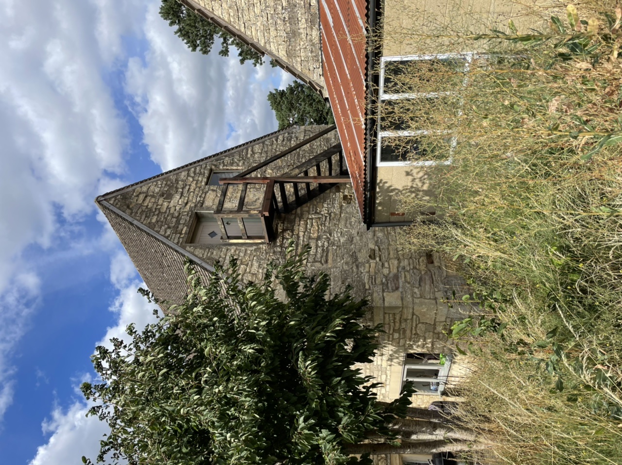

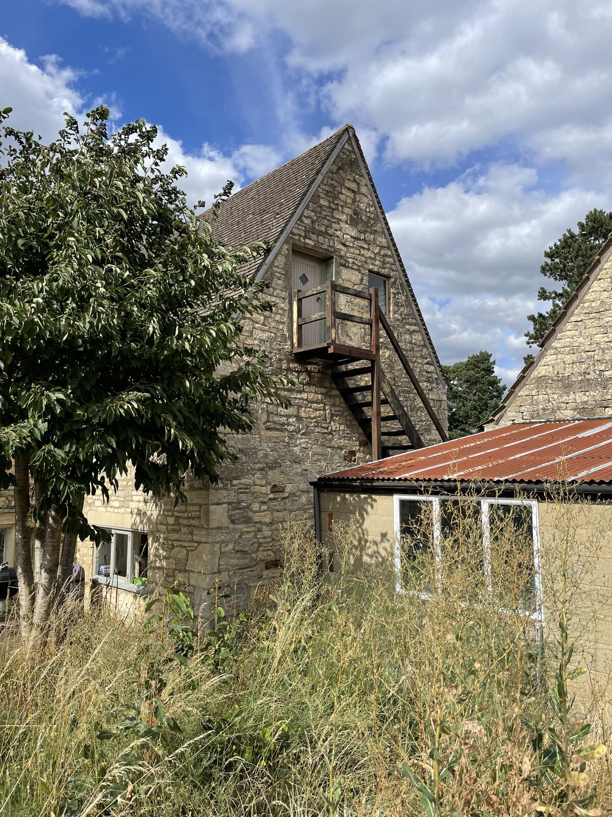

That’s a good idea but unfortunately the access isn’t great. I’ve attached some photos below. You could get a scaffold tower in next to it, but just dropping it in place or lifting it out isn’t a viable option.

Hard to tell from photos, but it looks easy (ish) to remove with common sense.
i would take a bloody good look at it but it seems from the photos to be reasonable to assume that you could cut off the stair handrail and surround from the balcony. That would reduce the weight. then possibly every other tread on the stairs.
it might be worth hiring a hefty chain hoist and fixing it to the balcony floor, so that it can be used to retain the support on the stairs. Ensure the chain can be accessed safely out of range.
