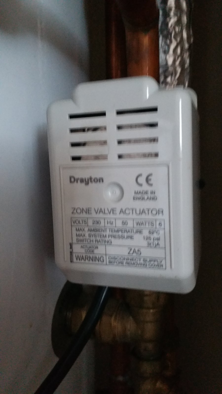

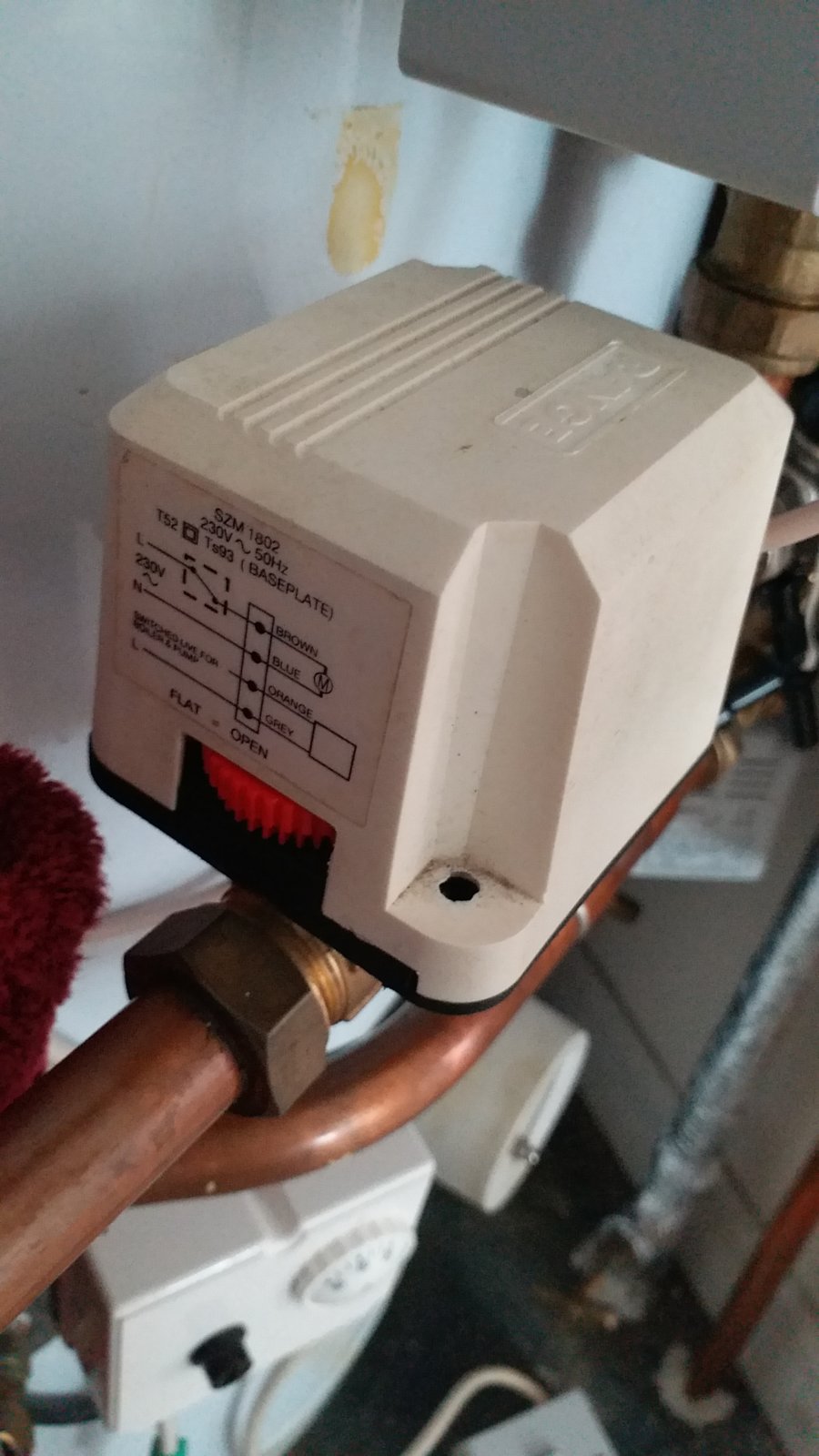

sounds like a sticking end switch on one of your zone valves rather than a boiler fault, but you do have a really poor boiler and the PCBs on them is total crap

I was going to suggest the microswitch until I noticed you said the pump is not running, I would hazard a guess that the pcb has gone faulty and to answer your question about the valve there is a permanent live in the valve that causes the boiler to fire regardless of room stat or programmer settings if the switch gets stuck.

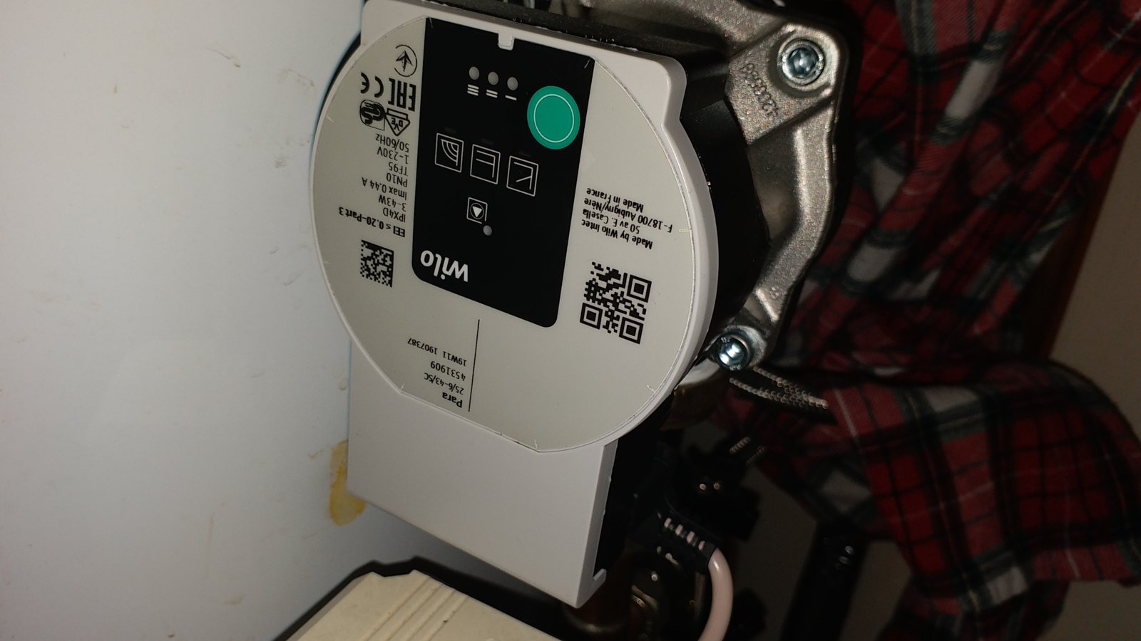

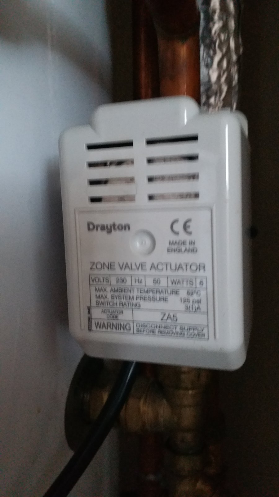

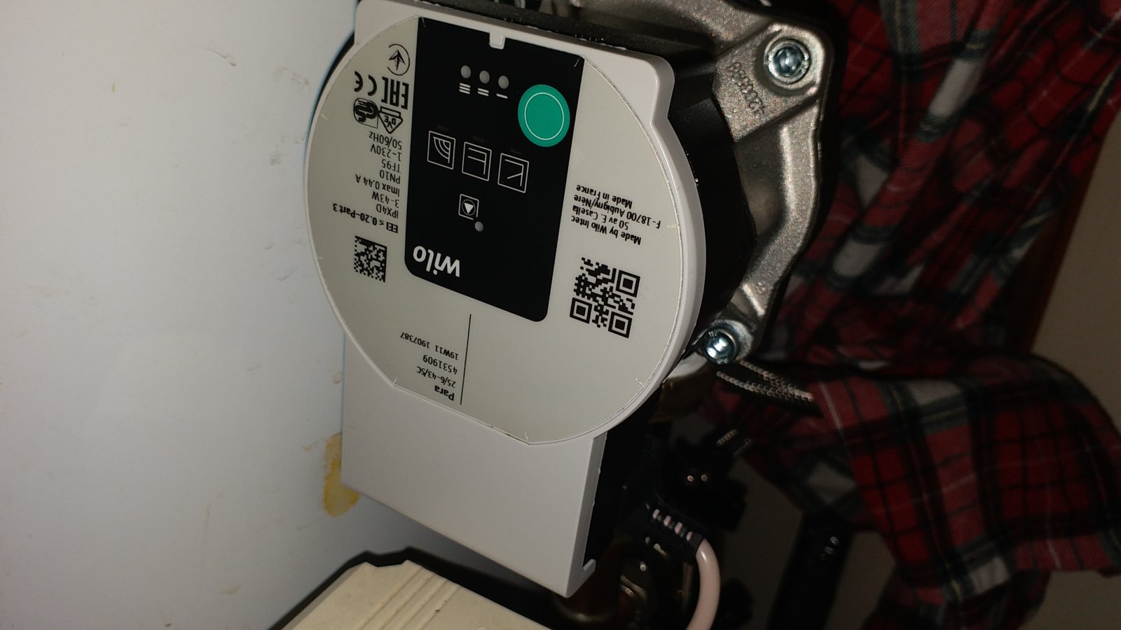

These are the zone valves I have. Drayton for HW and the other for CH. The CH actuator was changed a couple of months ago. The pump was new 3 months ago.

I can hear it cavitating inside, as none of the zone valves for the heating or water are opening and the pump is not running.
do you mean kettling ? if it is cavitating then the pump IS running and it is probably a stuck end switch as already said
