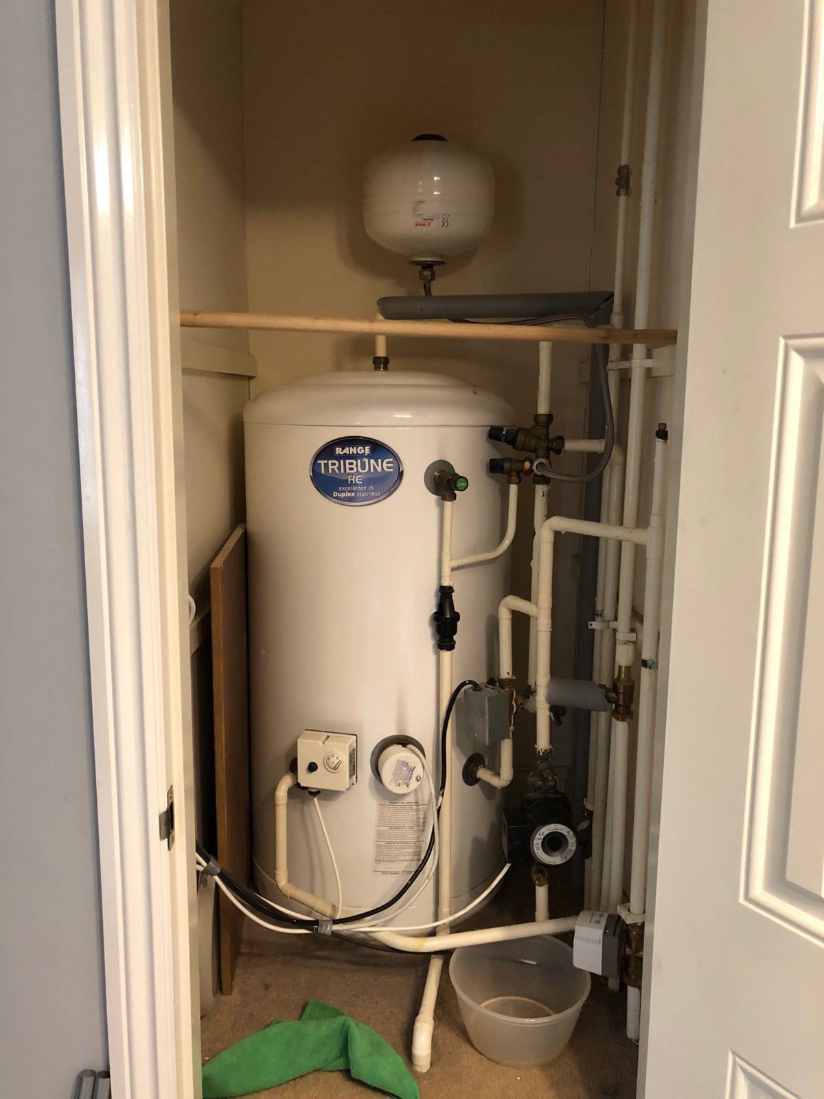

Hi, I have an issue with Ideal Icos system, low water pressure. I had no central heating after draining system to fit a towel warmer, this was due to an air lock in pump which I sorted thanks to this forum and now central heating works.
Now water pressure is very low. Think issue is boiler needs refilling but there is no red tank or refill valve anywhere that I can see as in other posts related to this. Pic of airing cupboard below. any ideas?

it could well be an open vented system,
i bet those two pipes going up into the loft are the open vent and cold feed.
but by the looks of the set up in your picture if your heating is working and has no air in it then so should your hot water, unless the 2 port is gubbed of course.

Hot water pressure from shower and taps is way lower than before I completed work. There is hot water now but around half the pressure I had before. Still thinking that the boiler hasn’t properly refilled maybe??
Your boiler /radiators are fed from a small tank ,usually in the attic. You do not have a filling loop to top up boiler pressure. The domestic hot water from the tank is delivered to taps / shower via mains water pressure. As you have closed your stopcock ,make sure it has been fully opened .

your work on the heating has nothing to do with the water coming out the tap,
as above, make sure the stopcock you closed is now fully open
