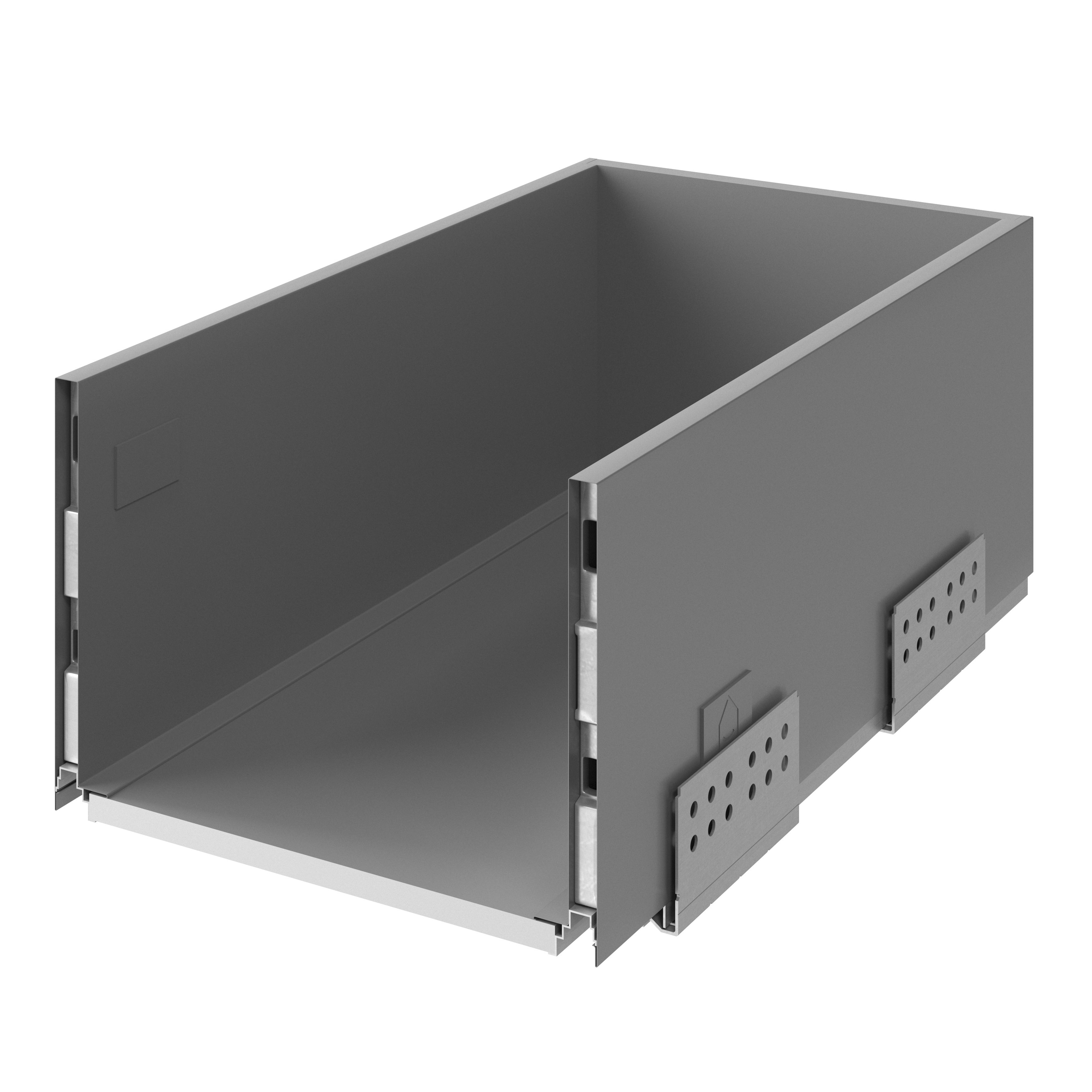

The other choice would be some drawers.
like this:https://www.ikea.com/gb/en/p/maximera-drawer-medium-white-20285035/
BUT I would need to reduce the width to 30cms somehow.

The drawer bottom looks like it is some form of sheet material (MFC or MDF), so I think no problems there. Can't see what the back is, but looks similar, so probably will also cut down. Maybe a quick visit to an IKEA store to confirm is in order? Even if they have metal backs, it might still be possible to jigsaw them to the appropriate size
The back is a shaped thin metal piece with an angled fold at the top and a shaped lower edge to trap the base in place.
I think cutting that would lose a lot of stiffness of the drawer.
I had one I bought that must have been a customer return, the side pieces were not quite straight and it would not open or close properly. I suspect cutting with a hacksaw would distort the shapes too much. I found another company that does blum drawers, but £130 for two! vs the £70 for 2 from B&Q (when comparing soft closing that the ikea provides). I have assembled quite a few already as we are doing the kitchen in stages to keep it usable. So I have seen the metal sides and rear panels up close.

The drawer bottom is mdf and that piece is simple to adjust, it is the metal bits that worry me. there are shaped plastic bits at the rear corners that couple the side and rear metal, after cutting to size it would need some precision cutouts to make things latch properly.
