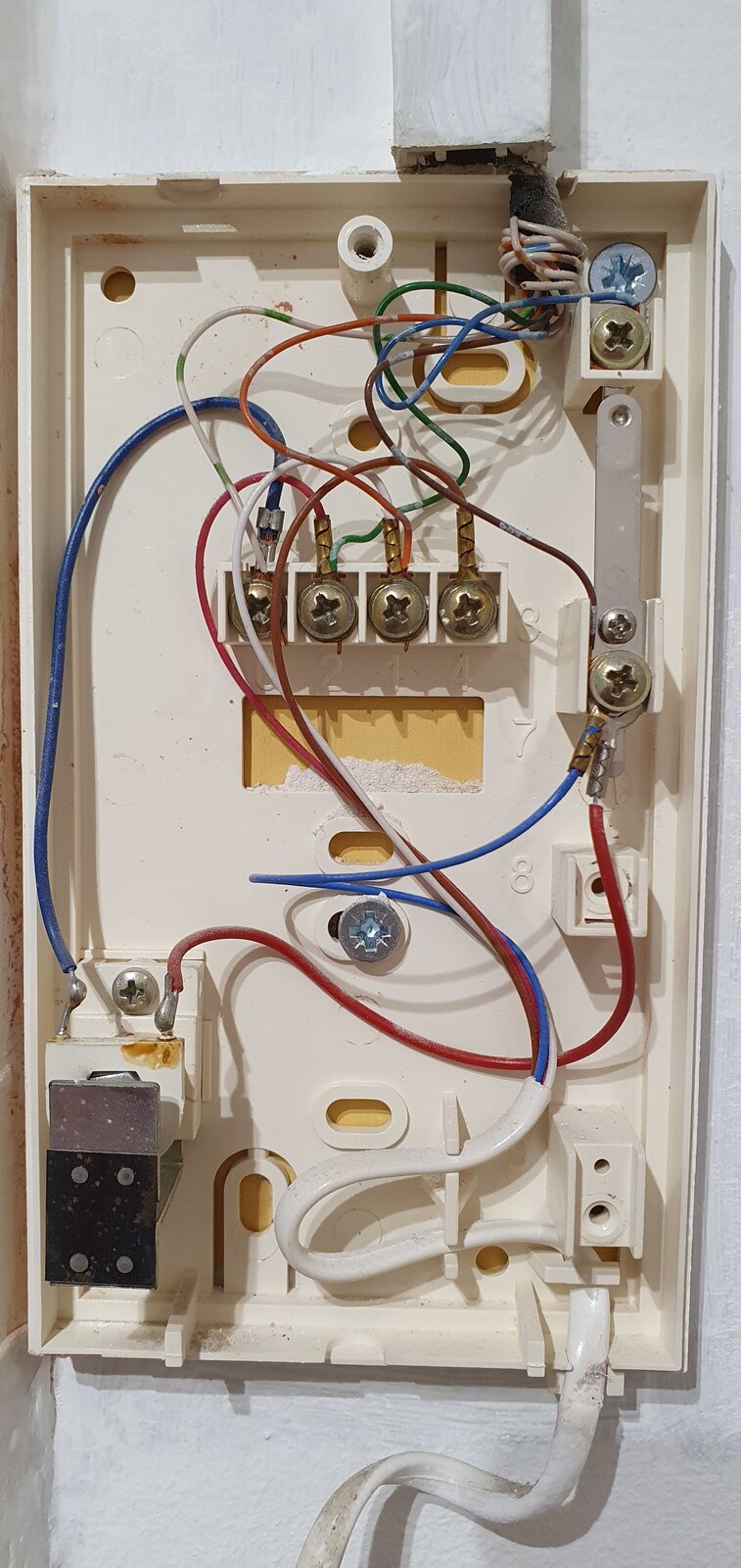

Hi guys first post here. I am in the middle of a major renovation of my flat and wanted to swap the intercom with a newer and smarter looking one. The old model is Videx smart 1 and would like to replace with fermax loft 3399. I have tried to follow the wiring diagrams and it actually works, however there is always a very very loud buzz which can be heard in the speaker in the handset and downstairs. PS I live in a block of flats.
Can anyone help please?

Your wiring config looks correct ....universal handsets are not guaranteed to work on every system ALLWAYS use the correct replacement handset and only use these as a last resort..also best practice is to use a pair if phone cable is used on the speech lines ...eg blue and white / white and blue for speech in /out
