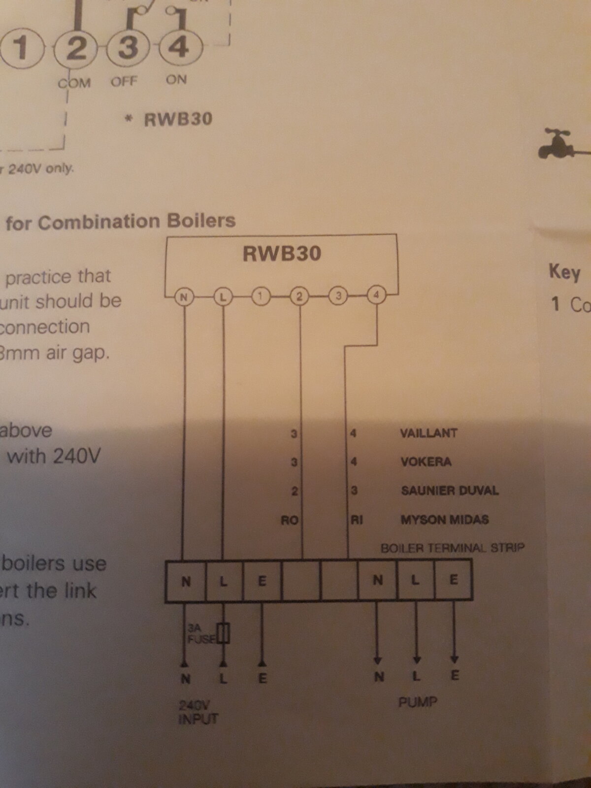

Hi I'm fitting a new timer/ controller to a greenstar 30si combi. I'm unsure whether its 240v or 24v. How can I check please.
It should be in the installation manual - there’s quite often revisions of the boiler, and I don’t know if controls form part of this.

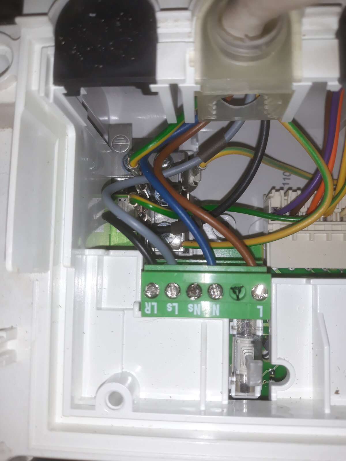

post pics of your existing timer and wiring, your boiler can be wired in different ways
  • Thanks
Reactions: CBW

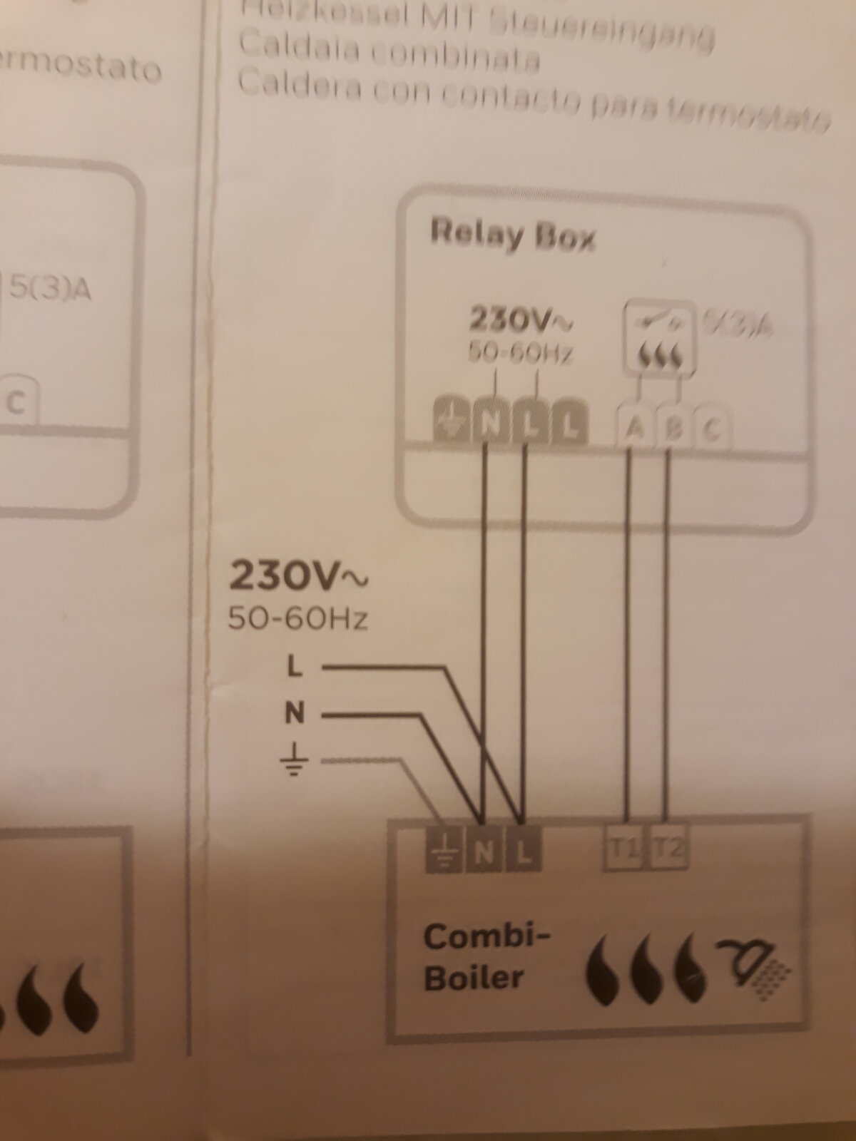

This is what I had and 240 going into honeywell home , so I need 240 for new timer. Is this correct or do I need check anything else.

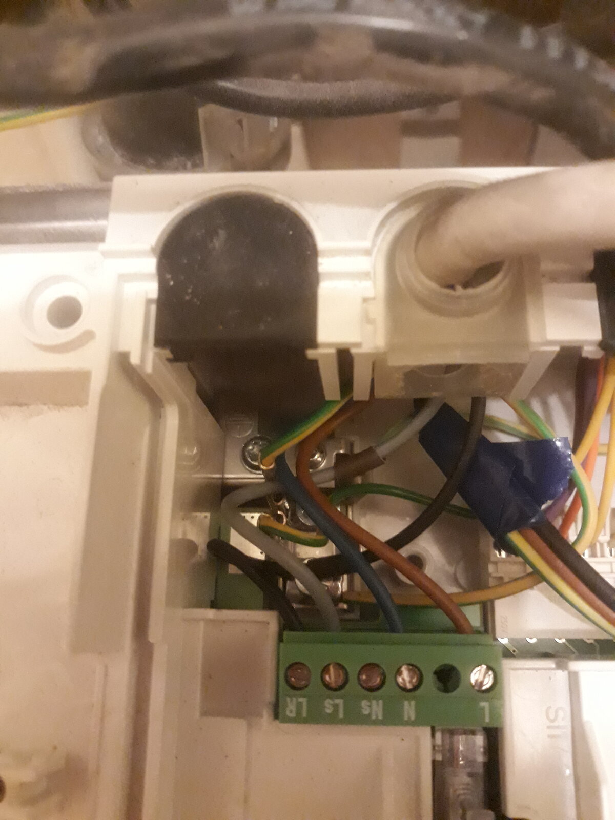

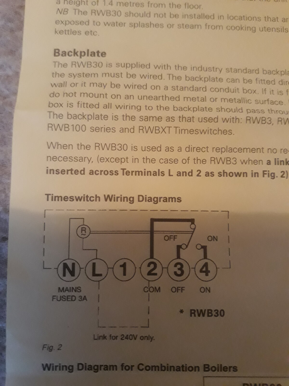

Hi, my mechanical timer isn't working correctly, the clock doesn't move unless I gently touch it. If I manually move it it works ok so I'm assuming the timer is faulty.
I've checked the connections and they're all good so think it must be timer, especially if I turn clock manually.
