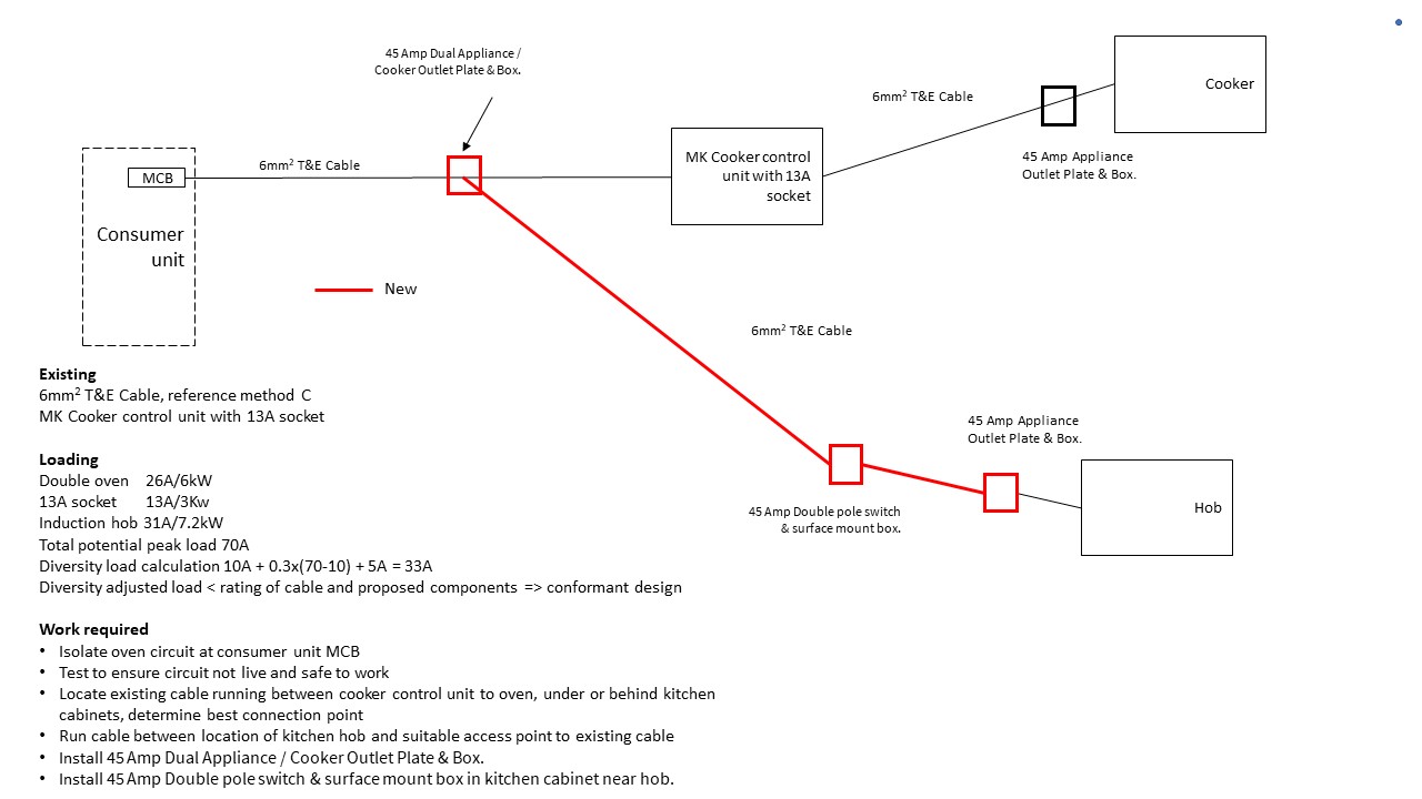

I'd be grateful for any comments on this proposed design. Is it OK from a regs viewpoint to have DP isolators downstream from the dual appliance connector?
As an alternative, could I just run a new cable back and power it from the same 45A MCB (no spares on the existing CU)?
I'm also curious about diversity. I'm guessing when we say a cable or MCB is rated at 45A, it is rated to be able to operate at that load continuously. But there is a different "unpublished" rating for peaky loads, which is what the diversity calculations is about. That is, for short periods the cable can carry in excess of that load. For example you put on a few rings on the hob and the two ovens, you are drawing well in excess of the "rated" load, but soon the cookers' thermostatic controls kick, turning the heating elements on and off. So 10A is the sustained load from the cookers, and up to 30% of the time, load can flex up to the peak load? Or something like that.
If you want to.
Are the cooker and hob to be fitted near each other?

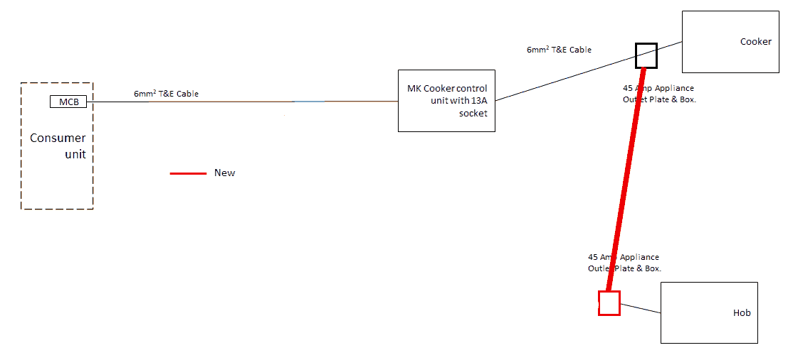

Just take the new cable from the oven outlet plate.

It would take a 3m run to get from the CCU to the hob location - c 2m as the crow flies.... The cooker control unit is installed on a tiled wall and I am not sure if we made provision for running cable in conduit.
The cleanest approach by the sound of it would be to run a second radial c. 6m to the 45A MCB. I did not realize that you could run a number of radials from the same MCB - but thinking about it, so long as you have planned the loads properly, there is no reason why it should be a problem.
Many thanks.

New cable connects to the existing oven outlet, not the wall switch.
Thank you. That's feasible - just have to take the oven out to get access and navigate the cable safely behind a built in dishwasher.
