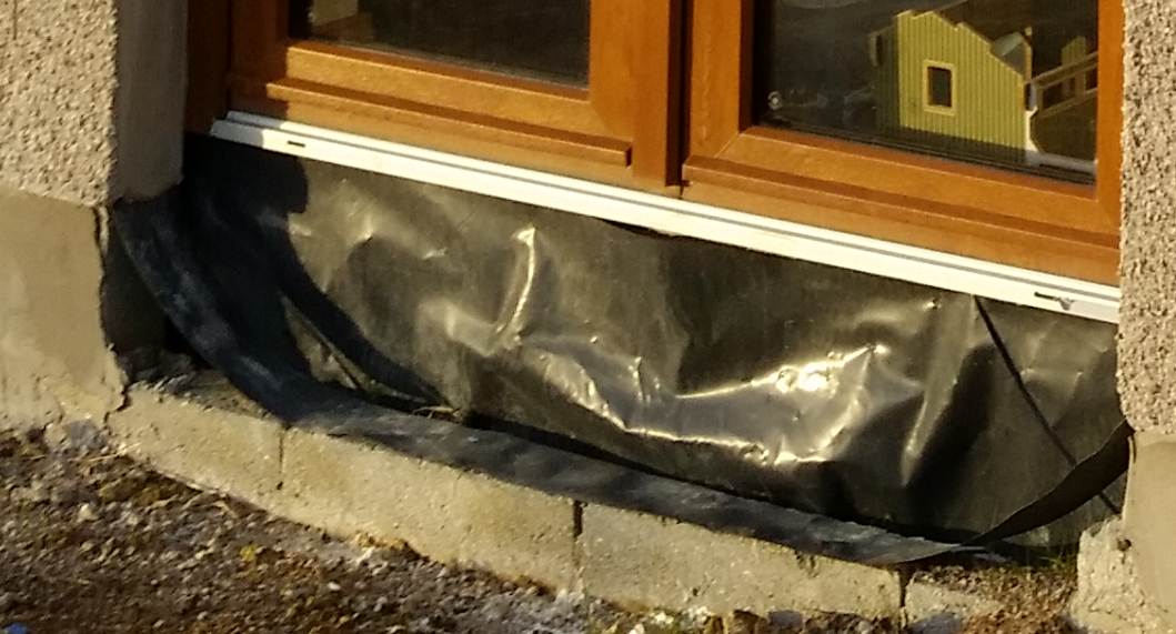

Hi, I have one small job to finish on an extension. The builder is no longer available so having to do this myself. There is a patio door and a back door with about 18 inch drop and currently no step and I need to put a step in to pass building control. Does anyone know how far down the step needs to be from the bottom of the door to meet regulations and for the water not to get in.

There are two ways to do it, either step out of the door and down onto the first step 6" below the floor level and then on down to another step. Or make the first step at around floor height do you step out level which I more comfortable but then you will need 3 steps.
3 steps 6" high is better than 2 at 9" which is really too high in my opinion. 9" is certainly too high for a first step out of a door so if you do go for 2x9" then do the platform arrangement.

If you make it the same height you have to watch for water. If you make it an inch lower you only need to worry about splashing water. If you make it 6 inches lower then you're fine for all water.
Is the area sheltered for rain? If not you would need to think about where it's going to splash to.
Doors have thresholds you know, someone has thought about water running into them before...
As for building your step its usually best to insert a sheet of dpc vertically against the wall behind the step to stop bridging the house dpc
Sorry I meant to write splashing not running. You can end up with penetrating damp around the door way that people think is rising, but it's actually from water splashing up the reveals.

You want the first step as tight under the sill as possible especially if the doors are UPVC, i.e. high threshold.
You do not want to avoid any amount of step down as your first step out of the building.
Hi, I have attached a picture. If i put the step in just under the pvc door then this will be above dpc level. Is this okay or do i need the top of the step to be below dpc? Also going by the picture would it be best to make the step the same width as the opening or slightly wider? Thanks again.
Hi I have attached an image. Tight under the pvc door would be above dpc level, is this okay to do? also, oging by the picture would you have the step hte same width as the opening or slightly wider?
