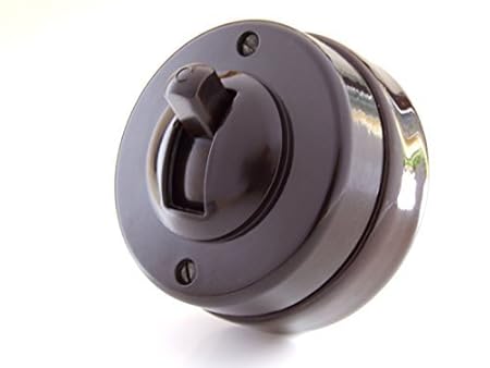

Something wrong with using switches on the walls?
You mean these?
Took them out a long while ago and used PVC insulated cable with earth conductor instead of lead sheath and rubber insulated conductors!!
Funny how technology moves on and doesn't stay static.
